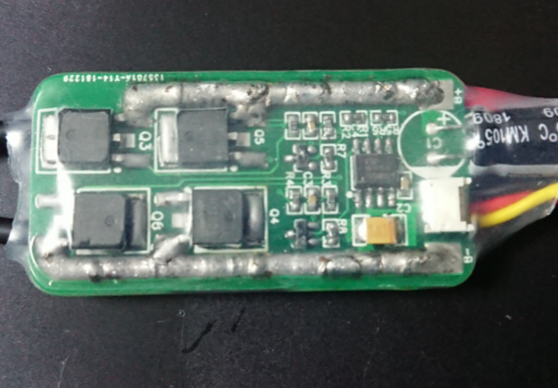

I touched one, Jialichuang made it for 30 yuan and made 5 yuan for SF MOS tubes. I chose HY1904D and HY19P03D in the mall, which are known as 5.8mohm on-resistance @4.5v. They are cheap and large, so there is no need to combine several. I tied them to a heat sink. According to the film, it is estimated that the 30A 7805 can be changed to dc-dc. The buck module can be used for anything. Just buy it from Taobao like the one in the schematic diagram. The input can reach 28v. The signal input is 1.25, and the soldering wire can be used. On the contrary
