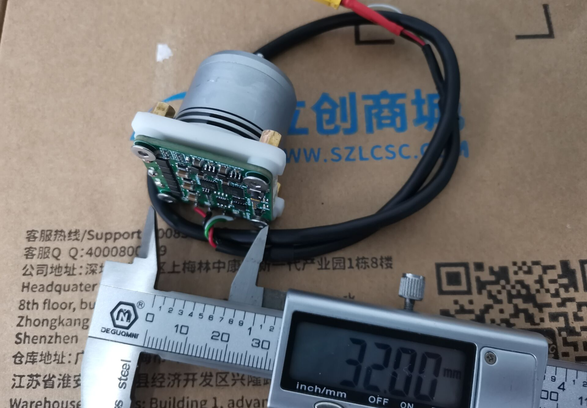

【CW32】Integrated FOC driver based on CW32F030K8U7
Preliminary hardware debugging completed
I only have a little time to work on social animals every day. The peripherals have been basically debugged, but the FOC has not been completed. The open-loop forced towing is running.
We will continue to promote this project in the future, so stay tuned
After complete adjustment, migrate to CW32

FOC didn't get it done, so they forced it to open a loop.
