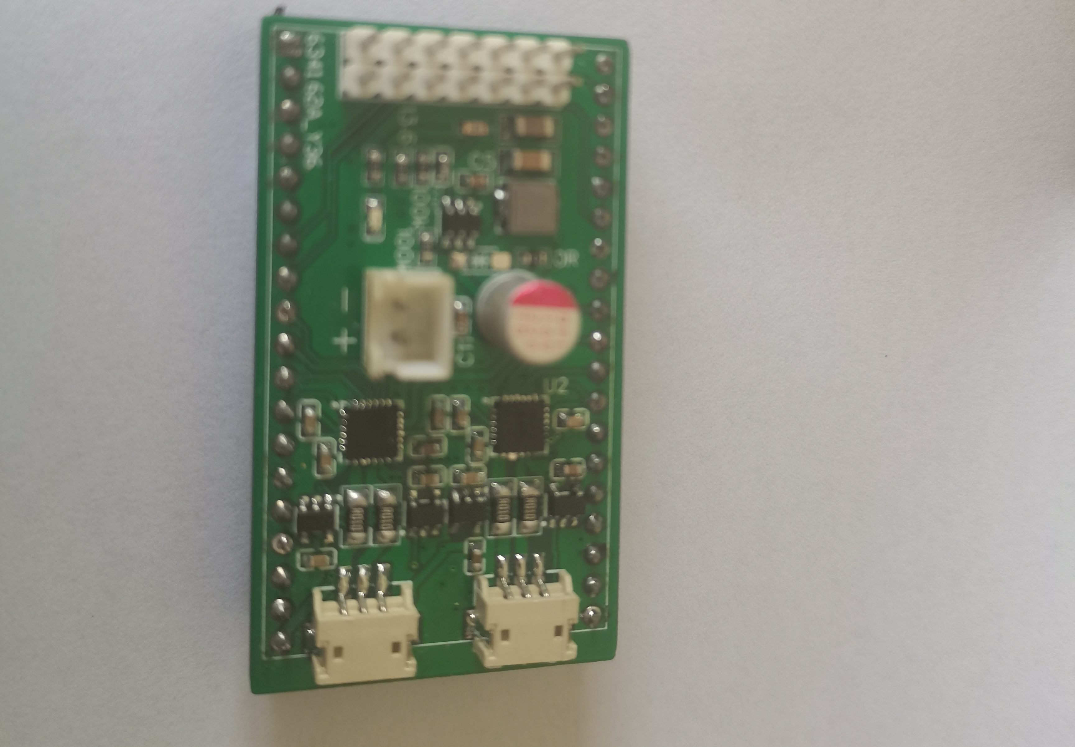

The driver core uses the domestic QFN24 package AT8325, with a power supply voltage of 4.7v-20V and a peak output current of 5.5A. The driver board uses INA180A2IDBVR to detect current. You can easily use the ArduinoSimpleFOC brushless motor driver library.
The motor sensor uses AS5600 and the I2C pull-up resistor is on the sensor board
