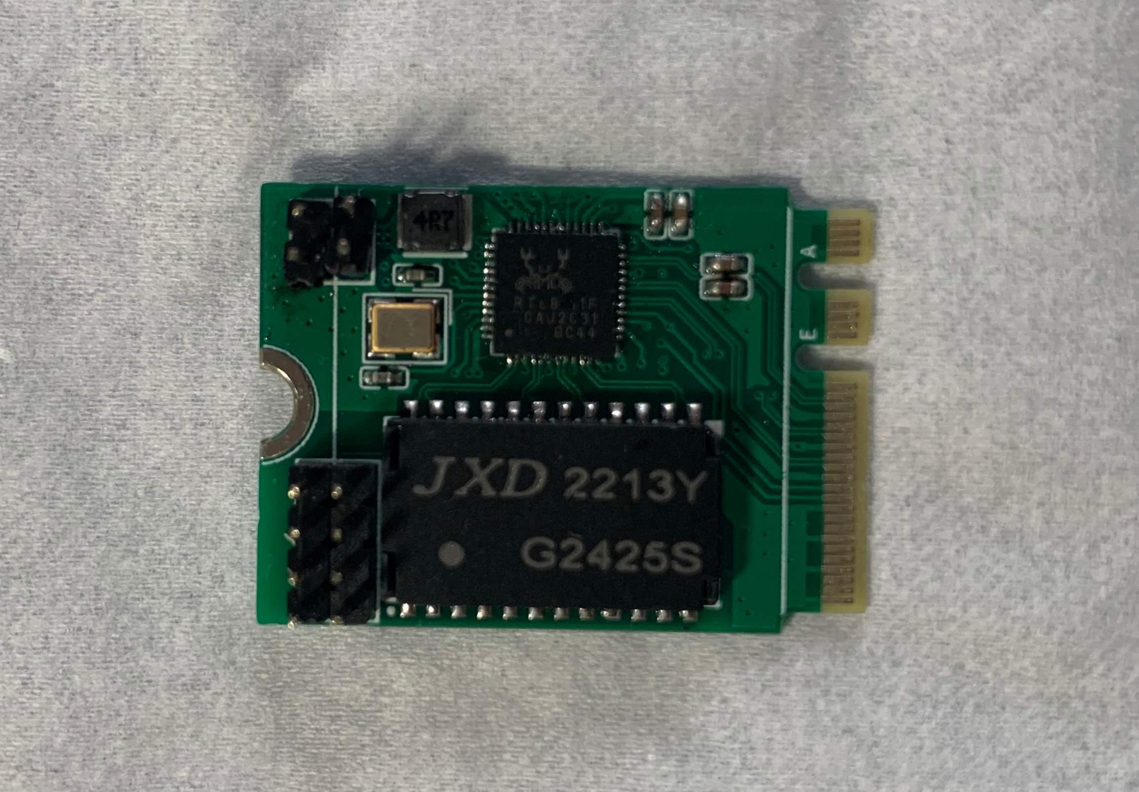

1. Preface:
  M.2 (A+E) to Gigabit network card open source works based on my MINI-PCIE to Gigabit network card
and another open source PCIE Gigabit network card
2. Chip description:
  RTL8111F and RTL8111E two chips are almost the same! But it's not exactly the same!
3. Board making instructions:
  The M.2 board type is 0.8mm thick.
  This time I have to pay 30 yuan (I feel uncomfortable and can’t do it in vain).
4. Instructions for getting started:
  Let me first talk about my computer configuration.
  CPU: QNCT (Magic Modified U)
  Motherboard: All-in-one motherboard H110 (BIOS has been changed)
  Memory module: Xiaoxiong DDR4 2400M (This memory module is a disassembled module)
  Solid state: Salted Fish Picked up Samsung 360G SSD
  graphics card: Huang Weida GT1030
  Chassis: Acrylic shell.
  I usually use this machine to run AI PCB traces and feed data to let it run 24 hours
  and then there are minor problems = =.
BUG description: There are currently two chances of running. The code errors are code 28 and code 10 (as shown below).
The solution is relatively simple! ! !
Just install the corresponding system driver (already placed in the attachment)
