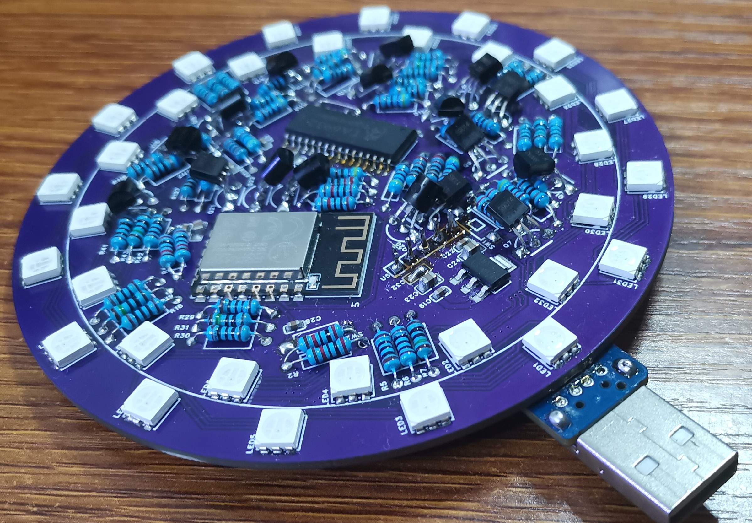

**When I created the project, I originally wanted to make a clock, but when I was drawing the schematic diagram, I took into account my own abilities and the fact that it was my first time to develop a project about the Internet of Things, so I simply made an RGB lamp. **
![a8a5df9001f669c3a9c1deec6005266.jpg]
# **Hardware**
![CH.png] 1. Considering that I personally prefer to solder plug-in components, most of them choose plug-ins. Because I have the CH340G download module, I left a module position on the bottom for easy welding. In the picture, the silk screen TXD is connected to the TXD of the download module, RXD is connected to the RXD of the download module, and VCC is connected to 5 volts.
![6916fd0844d4a06aa45f866b98a4291.jpg] 2. After actual verification, the blue light of LED1 on the outer ring will light up when no data is transmitted. It is currently speculated that this is the problem with TA6932. Therefore, the hardware circuit and software (will be mentioned later) need to be modified, that is, disconnect the 10th pin of TA6932 from the corresponding pad, and then connect a wire to the 16th pin on the 10th pad. The feet are connected.
![Short.png] 3. According to my circuit design, C32 does not need to be soldered, just short-circuit it.
![set.png] 4. For the peripheral circuit of the module, please refer to the design in the picture above.
![flat.png] 5. Refer to the level conversion circuit in the official document.

# Currently there are two problems:
1. It may be due to network speed and code problems that it takes a long time to display the main interface after switching modes.
2. When clicking the buttons on the phone screen to switch modes, sometimes there will be no response. It may be a code problem and you need to click more.
