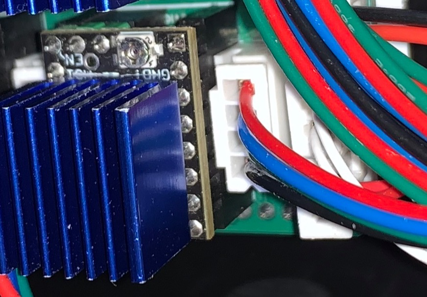

The 3D-printed shield is just enough to build a Voron 0 with the most basic functions. If you want to add more interfaces, you'll need to use it with a Raspberry Pi expansion cap. Connecting two printed shields should also work if you're using Klipper.
The V0 Simple Display has also been redrawn, using the same component positions for compatibility.
design is inspired by Protoneer's CNC Shield and the RepRap project's Arduino Mega Pololu Shield (RAMPS) (perhaps this board could be called the Arduino Uno Pololu Shield?).
This expansion shield is designed for use with the Arduino Uno R3, but theoretically it should be compatible with any development board using Uno-sized sockets. Many official MCU development boards support the Arduino pin layout (such as Renesas and STMicroelectronics).
To be compatible with both 3.3V and 5V development boards, it is powered via the IOREF interface on the Uno R3. This interface may not be present on some very old Uno development boards, so the external power input pad in the upper right corner can be used.
Development boards using Type-B interfaces (large square pins) may experience interference with MOSFETs. However, many Uno boards now use Micro-B or Type-C. Slightly moving the soldered MOS positions might eliminate interference. If that doesn't work, you can remove the Type-B interface and communicate directly using the Arduino's serial port (pins 0 and 1).
This design is primarily for Klipper, but other programs should also be compatible.
The TMC2209 stepper motor driver module is highly recommended. To save I/O, the En pins of all stepper motor drivers are fixed to GND to make them default to the ON state. The TMC2209 can control the driver's on/off state via a single-wire serial port instead of the En pin, so it can be turned off when not in use.
Additionally, the 3D printed shield does not have a power supply function, so separate power supplies are needed for the development board and Raspberry Pi. The 3D printed
shield's I/O interfaces are as follows:
Arduino Uno size-compatible header;
4 sockets compatible with Pololu stepper motor driver module pins;
2 heater interfaces;
2 fan interfaces;
3 limit switch interfaces (multiplexed with soft limit) ;
2 thermistor interfaces
. Please refer to the silkscreen on the PCB for the specific location of each interface.

Raspberry Pi Zero Extension Cap:
Since the 3D printing shield only guarantees the most basic printing function, using this extension cap can provide some additional interfaces. Similarly, this expansion cap does not have a power supply function.
The provided interfaces are as follows:
1 simple screen interface,
1 5V serial port,
1 I²C interface (connected to the screen interface's I²C)
, 1 ICSP-compatible SPI interface with two additional chip select pins,
2 fan interfaces,
2 switch interfaces,
2 relay interfaces , and
7 unexposed pins (their function is unknown).
