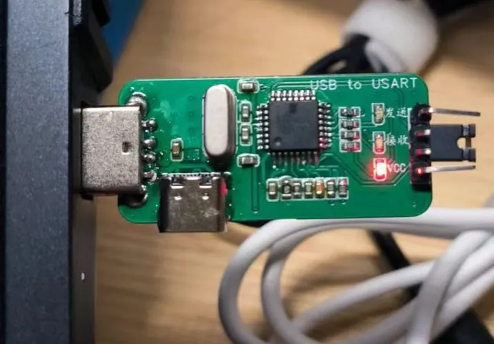

The FT232USB to serial port module can be used for programming and debugging.
This is the datasheet for this chip.
Shorting TXD and RXD with jumpers is used to test the chip's functionality
for transmitting and receiving signals and for the LED to light up.
The host computer needs to install the driver; see Attachment 2.
参考设计图片
