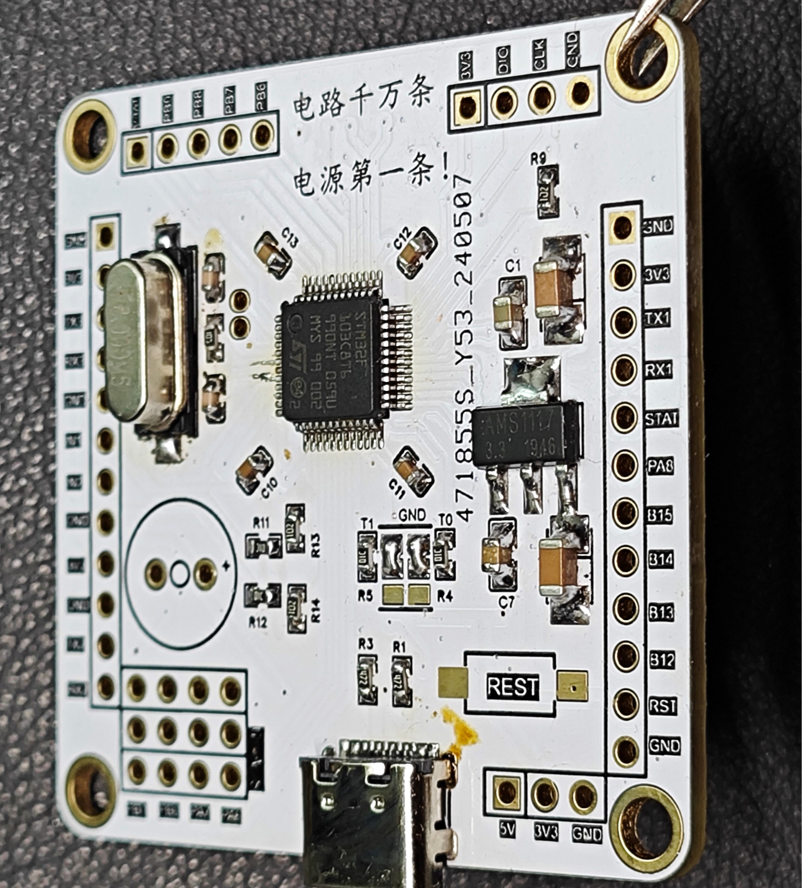

STM32_F103C8T6 Minimum System Verification Board
Functional Interfaces
: 1. Integrated C8T6 minimum system, pin compatible with 2.54mm perforated boards;
2. Onboard TYPE-C power supply port and CH340 serial port;
3. Active/passive buzzer;
4. Two sets of 3 LEDs, one set of general I/O, one set of PWM;
5. Integrated NRF2401 2.4G module small board interface;
6. Integrated JDY-31 series Bluetooth module interface;
7. Hardware IIC/UART3 interface
; 8. One set of PWM servo interface;
9. AMS117 3.3V voltage regulator circuit ;
10. BOOT selection solder jumper
; 11. Front pin header compatible with 2.54mm perforated boards, back pin layout mimics flight controller soldering points
according to function, dimensions 46.5mm*46.5mm. Current testing
shows
everything is normal, perforated board compatible, very suitable for testing.
Actual product image
: front
and back
pin configuration as shown .
