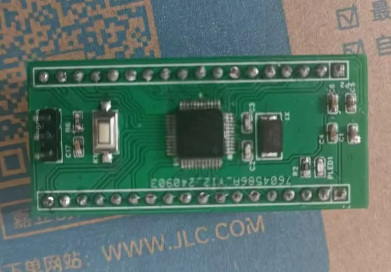

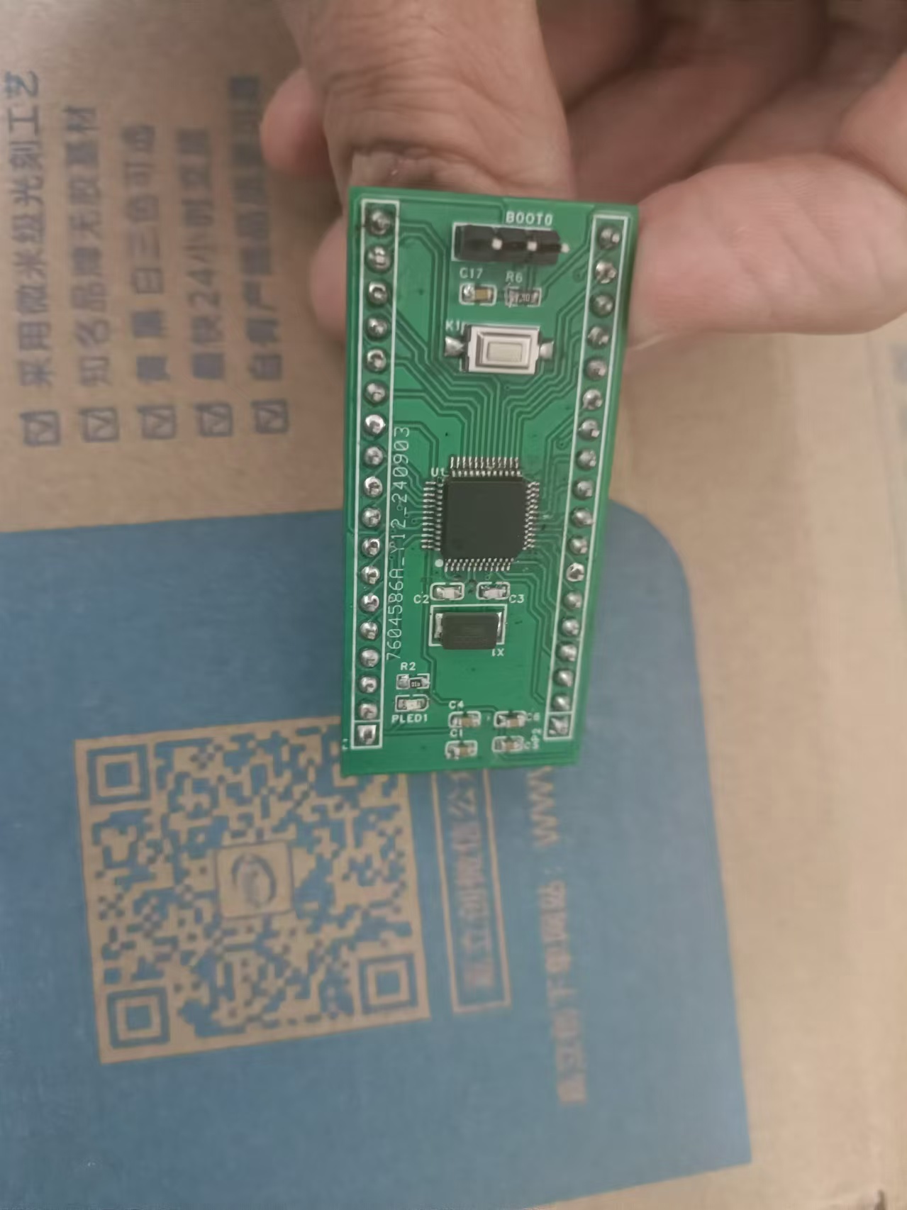

32 Minimum System Board
The STM32F103C8T6 pins are all brought out in sequence, and a power indicator light, reset button, and crystal
oscillator are soldered onto the actual component.
