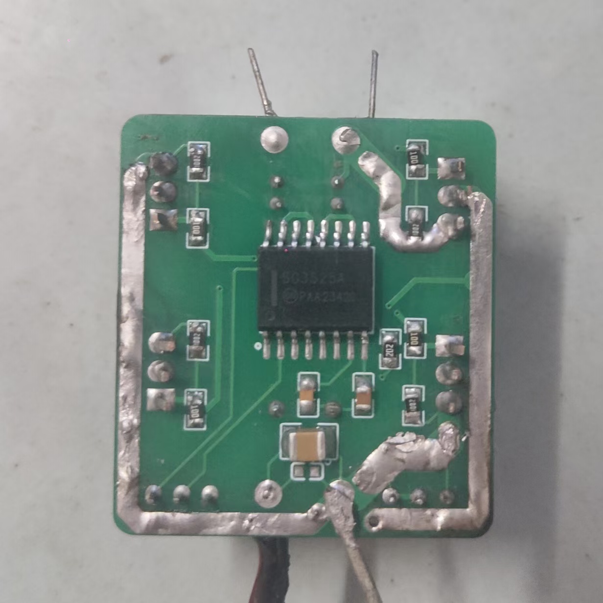

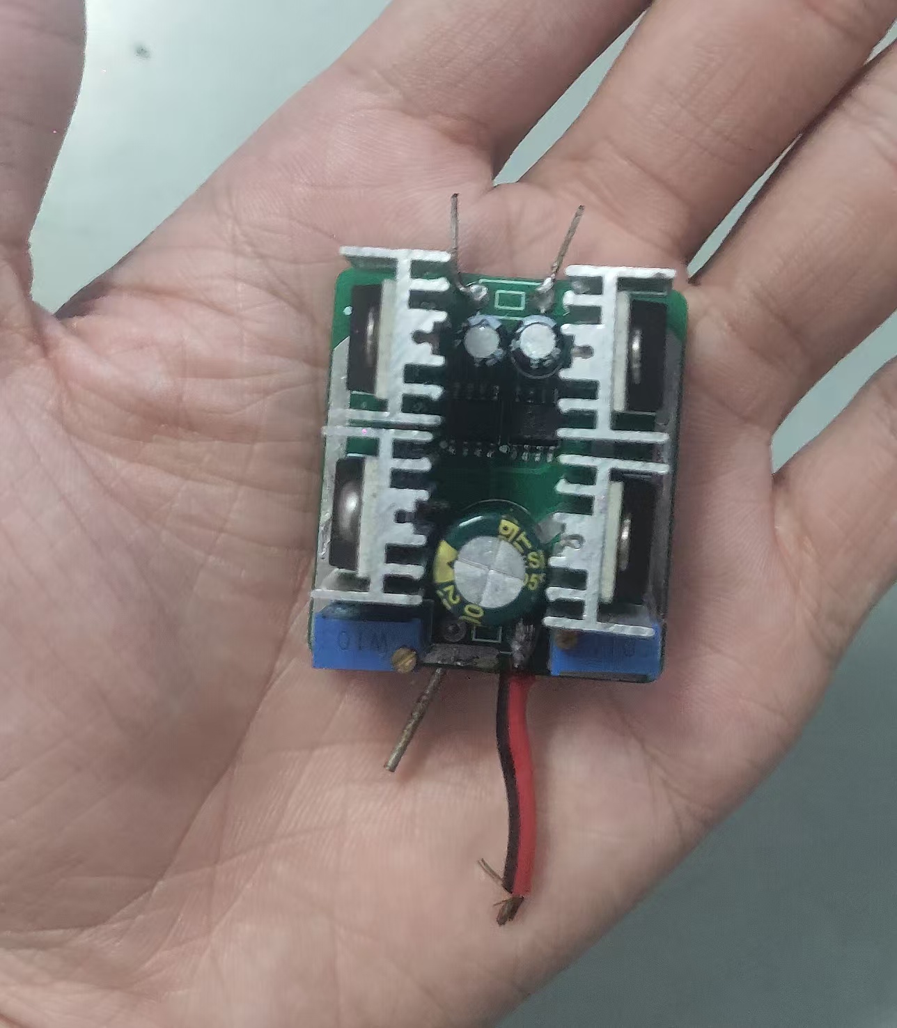

SG3525 Full-Bridge Inverter
SG3525 EG3013 Inverter Full Bridge
This circuit is based on https://oshwhub.com/wy3246/quan-qiao-ni-bian, but the original size has been reduced and the circuitry has been slightly modified.
Dimensions are 3.82cm x 3.44cm.

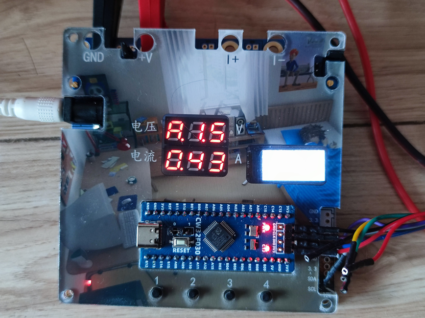

CW32 Voltage and Current Meter
Chuangdiwenxing CW32 Digital Voltage and Current Meter Expansion Board
I. Project Introduction
 An ADC (Analog-to-Digital Converter) is an indispensable key component in electronic systems. It converts continuous analog signals into digital signals, enabling digital processing and analysis. ADCs play a crucial role in signal conversion, measurement and data acquisition, control system input, and communication and signal processing. Their widespread application promotes the intelligent and precise control of electronic equipment across various industries, and is one of the key factors driving modern technological progress.
  Digital voltmeters and ammeters combine ADC technology with circuit measurement principles, accurately converting analog voltage and current signals into digital displays for easy reading and analysis by electronic engineers. This device not only improves the accuracy and efficiency of circuit measurements but also helps engineers better understand circuit behavior, making it a powerful tool for electronic design and troubleshooting, and playing a vital supporting role in the work of electronic engineers. In product applications, digital voltmeters ensure the accuracy and safety of circuit design, while also providing strong support for product quality control and subsequent maintenance.
II. Principle Analysis (Hardware Description)
1. Power Supply Circuit
LDO (Low Dropout Linear Regulator) Selection
This project uses an LDO as the power supply. Considering that most voltmeter products are used in industrial scenarios with 24V or 36V power supplies, the SE8550K2 with a maximum input voltage of up to 40V was selected as the power supply. The main reason for not using a DC-DC step-down circuit to handle the large voltage drop is to avoid introducing DC-DC ripple interference during the design process; a secondary reason is to reduce project costs.
2. Voltage Sampling Circuit
The voltage divider resistors in this project are designed to be 220K+10K, so the voltage division ratio is 22:1 (ADC_IN11).
Voltage divider resistor selection
(1) The maximum value of the designed measurement voltage. For safety reasons, this project is 30V (the actual maximum can be displayed as 99.9V or 100V);
(2) ADC reference voltage. In this project, it is 1.5V. This reference voltage can be configured through the program;
(3) Power consumption. In order to reduce the power consumption of the sampling circuit, the low-side resistor (R7) is usually selected as 10K based on experience; 3.
Current Sampling Circuit
This project uses a low-side current sampling circuit for current detection. The sampling current designed for the low side of the sampling circuit and the development board meter interface
is 3A. The selected sampling resistor (R0) is 100mΩ.
The sampling selection mainly needs to consider the following aspects:
(1) The maximum value of the pre-designed measurement current. In this project, it is 3A
; (2) The voltage difference caused by the current sensing resistor. It is generally not recommended to exceed 0.5V.
(3) The power consumption of the current sensing resistor should be selected according to the appropriate package. Considering the power consumption (temperature) problem under high current, a 1W packaged metal wire-wound resistor was selected in this project.
(4) The amplification factor of the voltage across the current sensing resistor: No operational amplifier was used to build the amplifier circuit in this project, so the amplification factor is 1.
III. Precautions
: Do not solder R0 during testing!
CW32 voltage and current meter code.zip
e65c218687a2d9ff08f74231ab285b1a.mp4
PDF_CW32 Voltage and Current Meter.zip
Altium_CW32 voltage and current meter.zip
PADS_CW32 Voltage and Current Meter.zip
BOM_CW32 Voltage and Current Meter.xlsx
92787

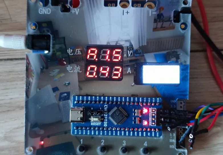

Diwenxing CW32 Digital Voltage and Current Meter
Video Link:
https://www.bilibili.com/video/BV18CWZeAEPG/
Project Introduction:
Thanks to LCSC and CW32 for providing this free training camp, and thanks to Engineer Li for the hardware explanation. The hardware explanation was very detailed, and I highly recommend it to beginners. The completion level this time is not as good as other experts. It's a pity that I didn't design a 3D shell and panel. I didn't think of LCSC's 3D shell design function at the time. It is quite suitable for beginners and very useful. In addition, SW was not downloaded at the time, so I didn't design
the project function
. Define 5 working modes. K1 is used to switch display modes. K2 sets the parameter value of the corresponding mode and saves it to FLASH. K3 returns to mode 0.
Mode 0: Displays normal voltage and current values ​​(the next row of digital tubes displays the voltage value .V or .V automatically switches, the previous row displays the current value _.**A).
Mode 1: Voltage 5V calibration value setting. The next row of digital tubes displays 5.05. The previous row displays the current voltage value _.V or ._V. In this mode, the multimeter should be set to 5.00V when measuring the measured bit. After pressing the K2 key, the current value is calibrated as a 5V voltage value.
Mode 2: 15V voltage calibration setting. The next row of the digital display shows 5.15. The previous row displays the current voltage value as _V or ._V. In this mode, the multimeter should be set to 15.0V when measuring the measured bit. After pressing the K2 key, the current value is calibrated as a 15V voltage value.
Mode 3: 0.5A current calibration setting. The next row of the digital display shows A.0.5. The previous row displays the current current value as _.**A. After pressing the K2 key, the current value is calibrated as a 0.5A current value.
Mode 4: 1.5A current calibration setting. The next row of the digital display shows A.1.5. The previous row displays the current current value as *.**A. After pressing the K2 key, the current value is calibrated as a 1.5A current value.
Project Parameters
: Measurable Voltage: 0-30V;
Measurable Current: 0-3A.
: Power Supply Circuit:
This project uses an LDO as the power supply. Considering that most voltmeter products are used in industrial scenarios with 24V or 36V power supplies, this project selected the SE8550K2 with a maximum input voltage of up to 40V as the power supply. The main reason for not using a DC-DC step-down circuit to handle large voltage differences is to avoid introducing DC-DC ripple interference during the design process; a secondary reason is to reduce project costs.
Voltage Sampling Circuit:
The voltage divider resistors in this project are designed to be 220K+10K, therefore the voltage division ratio is 22:1 (ADC_IN11).
The voltage divider resistor selection
is designed to measure the maximum voltage value. For safety reasons, this project uses 30V (the actual maximum display value can be 99.9V or 100V).
The ADC reference voltage is 1.5V in this project, and this reference voltage can be configured through the program.
To reduce the power consumption of the sampling circuit, the low-side resistor (R7) is usually chosen as 10K based on experience.
Then, the high-side resistance of the voltage divider resistor can be calculated using the above parameters.
The required voltage division ratio is calculated, i.e., the ADC reference voltage. The input voltage is designed; using known parameters, 1.5V/30V = 0.05 can be calculated.
The high-side resistance is calculated as the low-side resistance/voltage division ratio; using known parameters, 10K/0.05 = 200K can be calculated.
A standard resistor is selected: a resistor slightly higher than the calculated value of 200K is chosen. We usually choose E24 series resistors; therefore, in this project, 220K, which is greater than 200K and closest to the calculated value, is selected.
If, in actual use, the voltage to be measured is lower than 2/3 of the module's design voltage (66V), the voltage divider resistor can be replaced and the program modified to improve measurement accuracy. The following example illustrates this:
Assuming the measured voltage is no higher than 24V and other parameters remain unchanged,
calculations show 1.5V/24V = 0.0625, 10K/0.0625 = 160K. 160K is a standard E24 resistor and can be directly selected, or a higher value 180K can be chosen with some redundancy.
If, in actual use, the voltage to be measured is higher than the module's 99V design voltage, a different resistor can be selected. To achieve a wider voltage measurement range, one can choose to replace the voltage divider resistor or modify the reference voltage. The following example illustrates this:
Assuming the measured voltage is 160V, the solution is to increase the voltage reference to expand the range.
Given that the voltage division ratio of the selected resistor is 0.0145, we can calculate 160V * 0.0145 = 2.32V using the formula. Therefore, we can choose a 2.5V voltage reference to expand the range (increasing the range will reduce accuracy).
Considering the potential fluctuations in the measured power supply, a 10nF filter capacitor is connected in parallel with the low-side voltage divider resistor to improve measurement stability.
Range switching:
In this project, an additional voltage sampling circuit was added. Therefore, we can discuss the significance of range switching for improving measurement accuracy. Multimeters often have multiple range settings for more accurate measurements. By adjusting different ranges, the optimal measurement accuracy of the measured point within the corresponding range can be obtained.
This project requires a combination of hardware and software to achieve this function. When we first use the ADC_IN11 channel mentioned earlier to measure voltages below 30V... If the measured voltage is within 0~3V, the ADC_IN9 channel is used for measurement. At this time, due to the reduced voltage division ratio, the measurement accuracy is greatly improved.
There are many ways to implement gear shifting, and the development board design provides more design possibilities.
Current sampling circuit
design analysis:
The sampling current in this project is 3A, and the selected sampling resistor (R0) is 100mΩ.
the maximum value of the pre-designed measurement current,
the voltage difference brought by the 3A current sensing resistor in this project, generally not recommended to exceed 0.5V
; the power consumption of the current sensing resistor should be selected according to this parameter. Considering the power consumption (temperature) problem under high current, a 1W packaged metal wire-wound resistor was selected in this project;
the voltage amplification factor of the current sensing resistor: no operational amplifier was used to build the amplification circuit in this project, so the factor is 1.
Then the current sensing resistance value can be calculated using the above parameters. Selection:
due to This project does not use an amplifier circuit, therefore a larger sampling resistor is needed to obtain a higher measured voltage for measurement.
Considering that a larger resistor would result in a larger voltage drop and higher power consumption, an unlimited selection of a larger resistor is not feasible .
This project uses a 1W package resistor, corresponding to a power consumption of 1W.
Based on the above data, a 100mΩ current-sensing resistor was chosen. According to the formula, 3A * 100mΩ = 300mV, 900mW.
To handle different operating environments, especially high-current scenarios, the R0 resistor can be replaced with constantan wire or a shunt. The choice of alternative can be based on the specific application scenario. For safety and educational purposes, this project will not discuss measurements exceeding 3A, but the principle remains the same.
Precautions
Actually, the beginning was basically the same as in the training camp. The difference was that I chose surface mount components for most of them. To be honest, I was hesitant to choose surface mount components initially, but thanks to the answers from the experts in the group, I decided to. These past few days, while doing physical verification, I saw Li Gong say in a new video that people are just a little afraid. As long as you pay attention to the parameters you chose beforehand, just boldly select and use the components. I really understand this. The fear of not choosing was just because I was afraid of not doing it well. But what if I don't do it well? I can just draw another version, haha. Another difference is that I chose to directly lay copper instead of single-point grounding. Later, I heard from Li Gong that the current sampling resistor area is the power ground, so I directly implemented ground isolation (I think that's fair). Then I asked a senior student, who said it wasn't a big problem, so I did it that way. Thanks again to my brother Long for his help. Let
me also ramble on about the small troubles and insights I encountered during these few days of physical verification.
Although Li Gong suggested that we should still learn about CW32 development, I chose to just abandon it and directly burn the official program. Actually, when burning Example 9, there's no need to skip soldering the current sampling resistor; just solder it on directly. Then you can adjust it directly using a voltage and current source.
This time I only just realized that digital tubes come in so many sizes. When buying one, be sure to check the display size carefully.
Also, if your multimeter is like mine, when measuring current, be sure to move the green probe to the left current setting, otherwise you won't get a reading
. Oh, and the connector—don't choose a pin header like I did. Although thin DuPont wires can handle 3A, it's really inconvenient.
After buying the components, I realized I forgot to buy a monolithic capacitor. Later, following Yunmo's advice, I replaced the monolithic capacitor with a ceramic capacitor I had on hand, and it worked perfectly.
