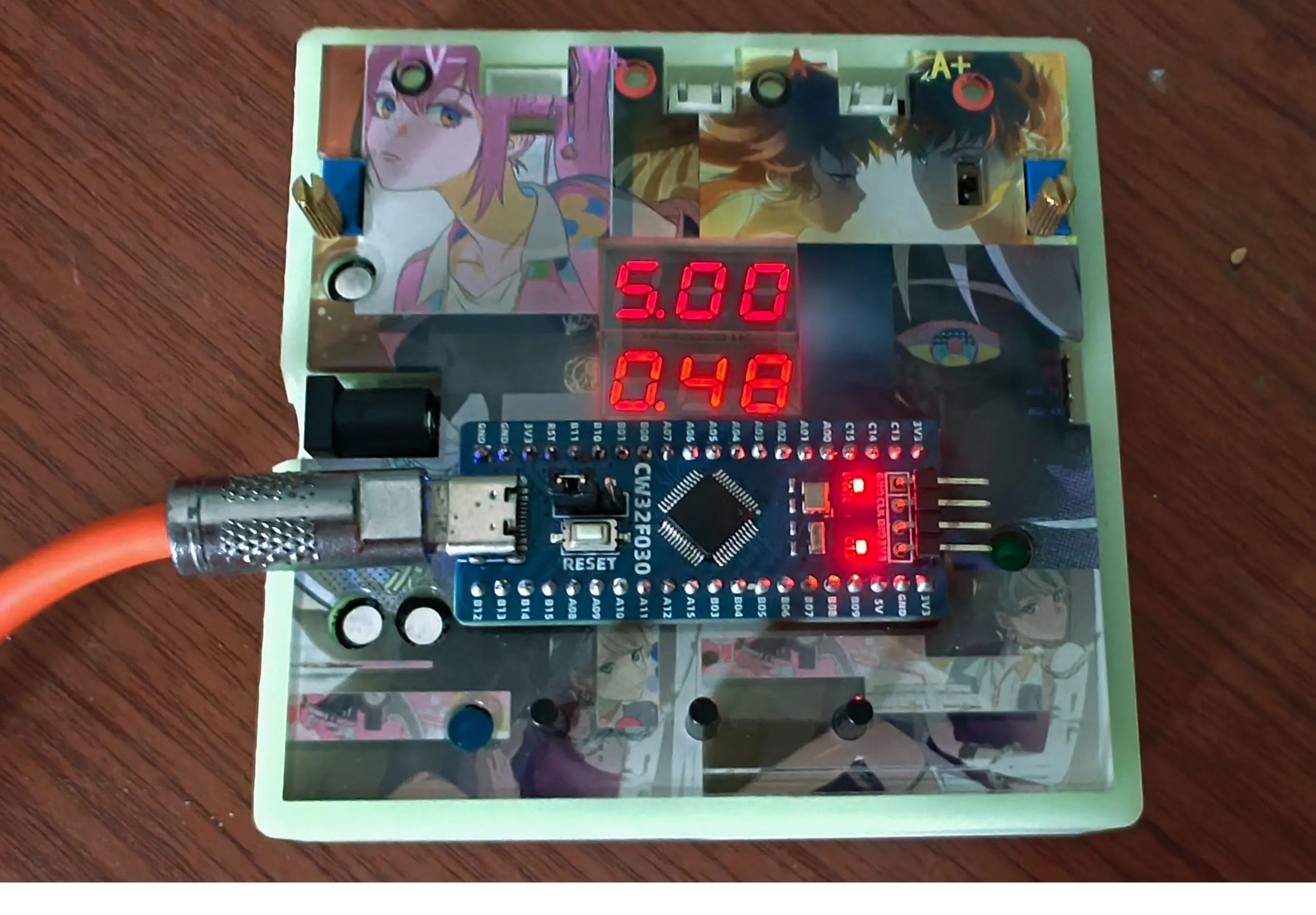

    This project uses the LCSC CW32F030C8T6 development board. Detailed tutorials and materials are available on the LCSC development board website, including the "CW32 Digital Voltmeter and Ammeter Training Camp Project Tutorial Document." This project is
    a complete replica of the training camp project, with no changes to the circuitry or code.
    Digital Voltmeter and Ammeter with Calibration Function

The reference example uses 3 calibration points. The voltage calibration points are 0V, 5V, and 15V. The current calibration points are 0A, 0.5A, and 1.5A.
3. Calibration Operation Method for this Experiment
This example uses button operation for calibration. The specific operation method is as follows:
Define 5 working modes. The K1 key is used to switch the display mode. The K2 key sets the parameter value for the corresponding mode and saves it to FLASH. The K3 key returns to mode 0.
Mode 0: Displays normal voltage and current values ​​(the upper row of the digital tube displays the voltage value *.V or .*V automatically, the lower row displays the current value _.**A).
Mode 1: 5V voltage calibration value setting. The upper row of the digital tube displays 5.05. The lower row displays the current voltage value _.V or ._V. In this mode, the multimeter should be set to 5.00V to measure the measured bit. After pressing the K2 key, the current value is calibrated as a 5V voltage value.
Mode 2: 15V voltage calibration value setting. The upper row of the digital tube displays 5.15. The lower row displays the current voltage value _.V or ._V. In this mode, the multimeter should be set to 15.0V to measure the voltage of the measured part. After pressing the K2 key, the current value is calibrated to 15V.
Mode 3: Current 0.5A calibration setting. The upper row of the digital display shows A.0.5. The lower row displays the current current value _.**A. After pressing the K2 key, the current value is calibrated to 0.5A.
Mode 4: Current 1.5A calibration setting. The upper row of the digital display shows A.1.5. The lower row displays the current current value *.**A. After pressing the K2 key, the current value is calibrated to 1.5A.
