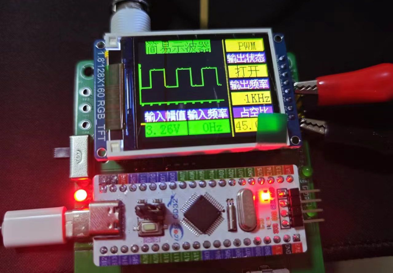

Simple Digital Oscilloscope:
(1) Power supply circuit: The LCSC GD32E230C8T6 development board is used to convert 5V to 3.3V via LDO.
(2) Analog front-end processing circuit: The input analog detection signal is processed and then sent to the microcontroller for identification. The specific circuit includes AC/DC coupling selection circuit, voltage attenuation circuit, and signal processing circuit.
(3) Microcontroller part: The LCSC GD32E230C8T6 minimum system development board is directly connected to the motherboard .
(4) Human-machine interaction circuit: Used to control the oscilloscope functions, including buttons, encoder, 1.8-inch TFT LCD screen, providing a foundation for the development of oscilloscope functions.
Measurement range: -80V — +250V
Refer to the official case.
