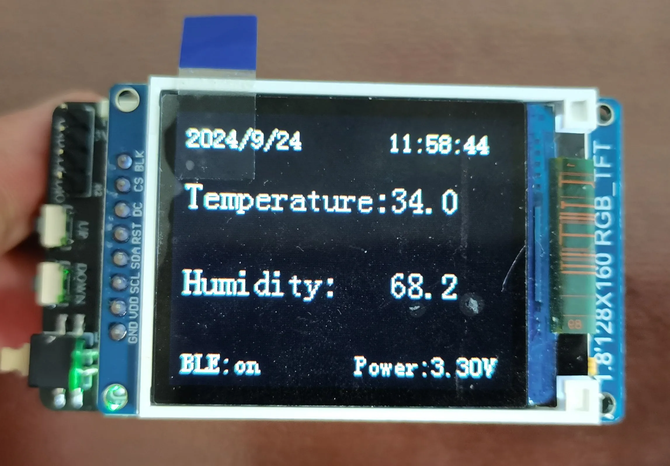

The code writing section first needs to implement the page display, including the date, time, current temperature and humidity, Bluetooth status, and power supply voltage
. The date and time modification interface implements functions such as time modification and cursor blinking. The rules are: the last two digits of the year, month, date, hour, and minute can be changed. Pressing the UP/DOWN button without any operation will switch to page 0. The first press of the CONFIRM button locks the YEAR value; pressing the UP/DOWN button again will change the YEAR value. Pressing the CONFIRM button again will move the cursor to the next value. Press the CANCEL button to adjust the end date and time.

 : Power on the temperature and humidity detector and get the following interface.
Press the left up and down keys to enter the date and time setting interface. Press the OK/Cancel key in the upper right corner and the left up and down keys to increase or decrease the time.
After setting, press the left up and down keys to switch to the temperature and humidity detection interface. You can see that the time has been successfully set.
