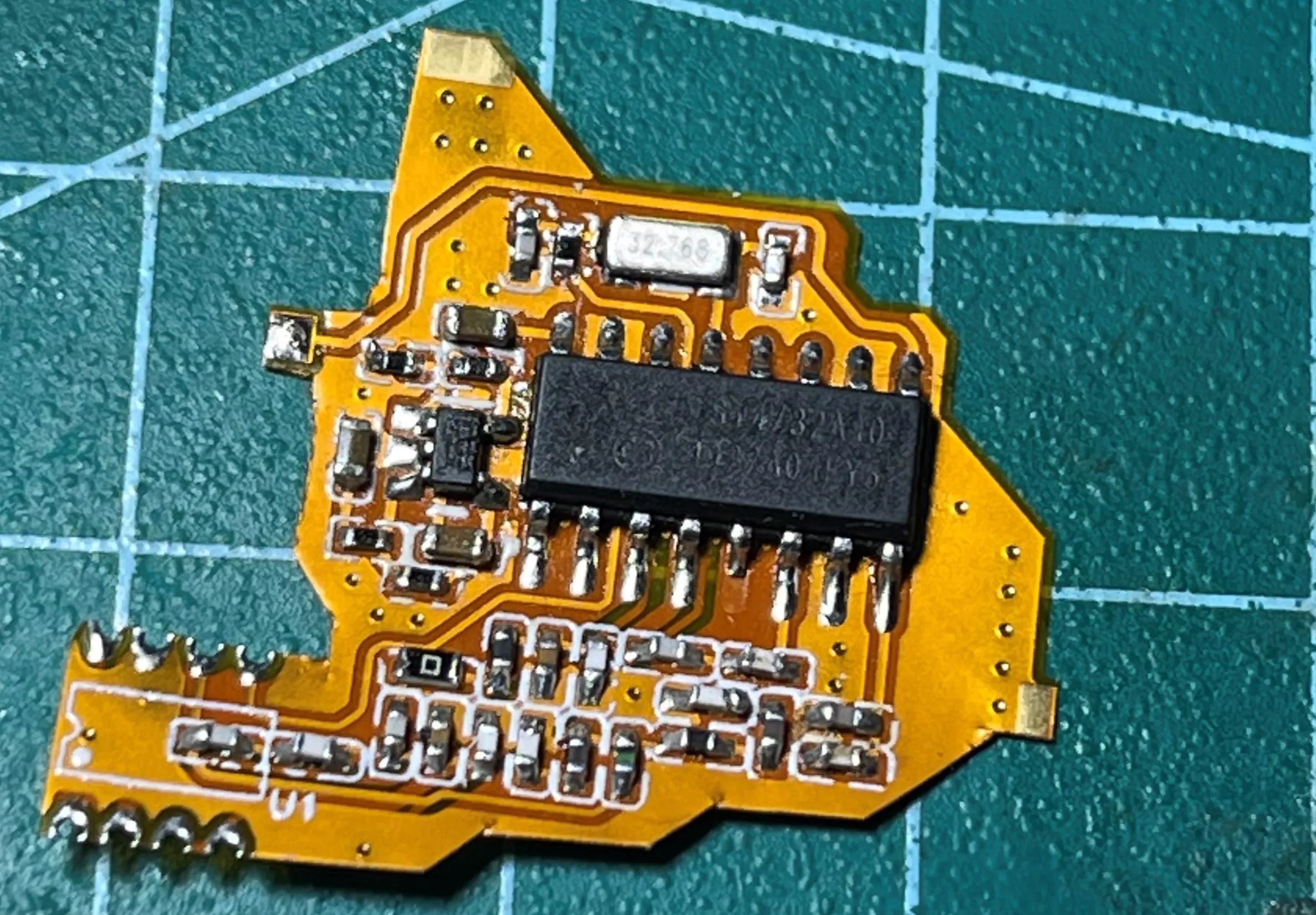

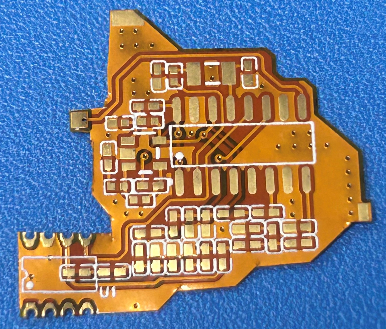

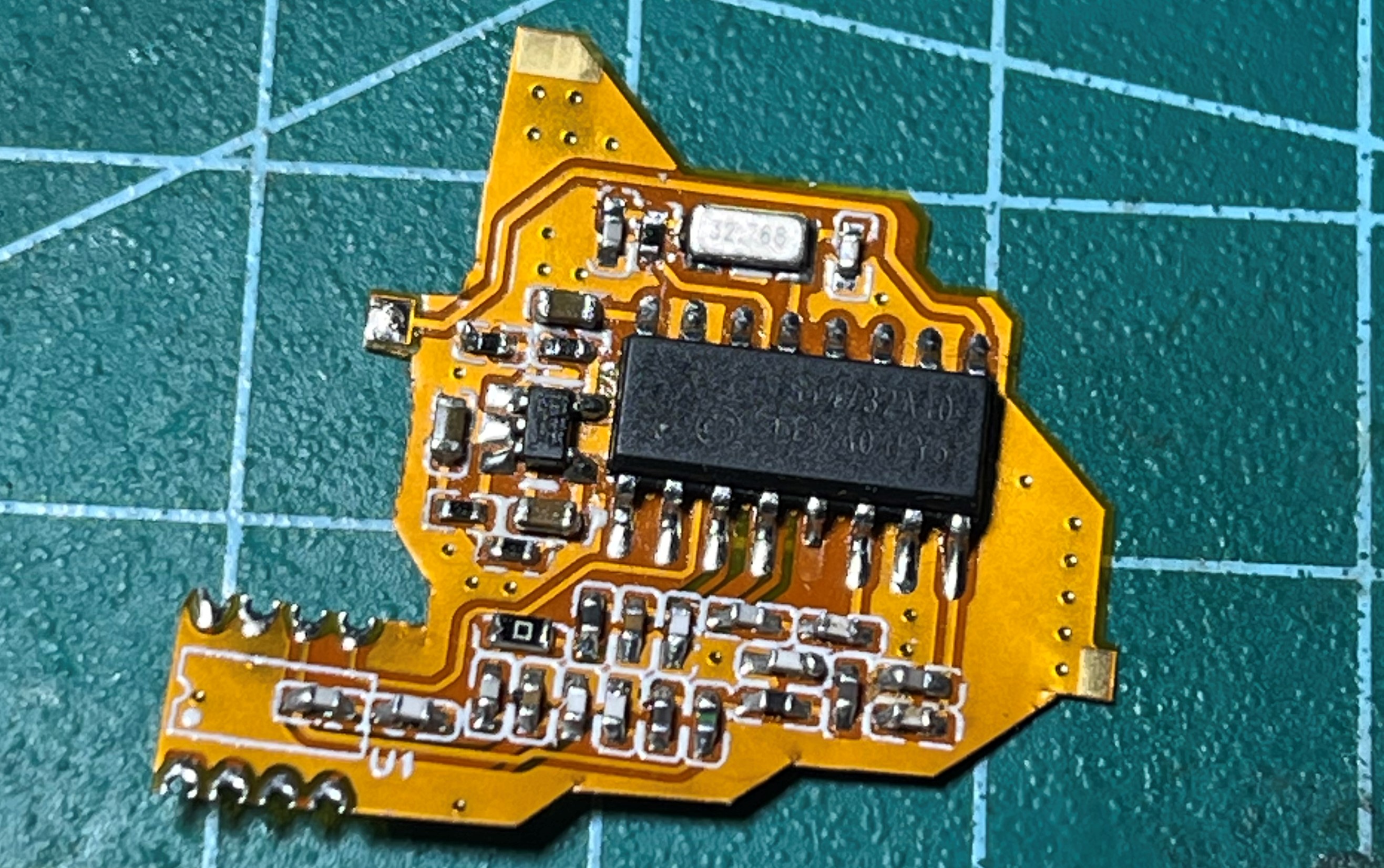

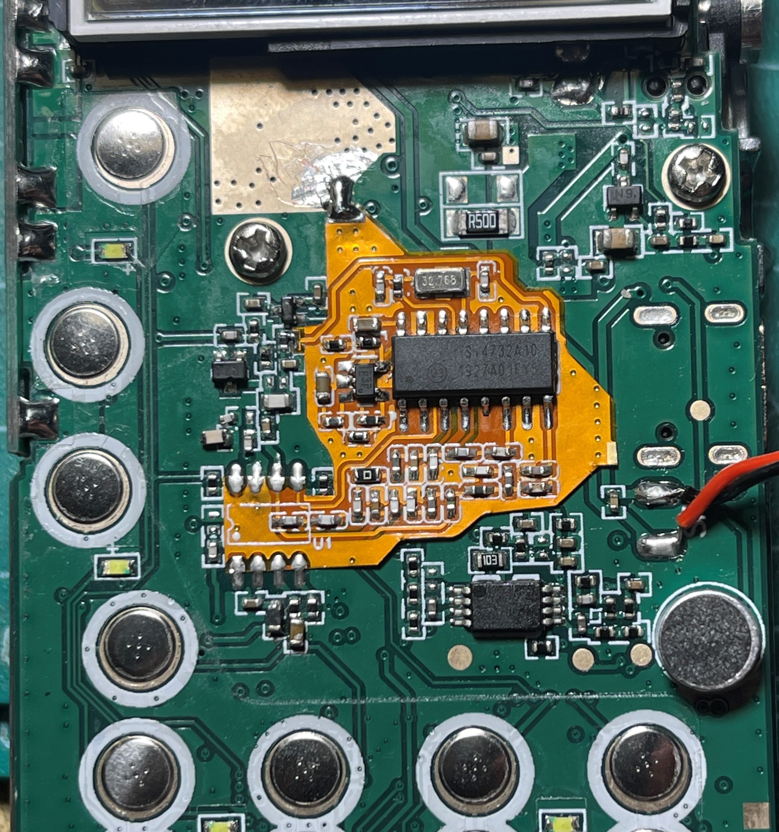

UV-K5 and UV-K6 with SI4732

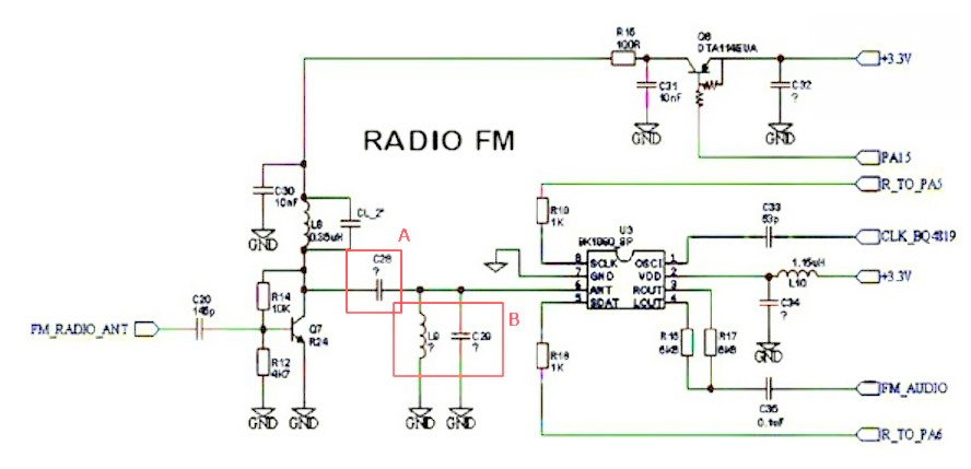

Precautions:
1. The output capacitor of the original R24 transistor amplifier circuit needs to be increased to 10nF or more (point A), and the LC filter at pin 6 of BK1080 needs to be removed (point B).
2. RST is connected to the collector of the power supply transistor (DTA114) of the original R24 amplifier circuit.
Second version:
1. Due to the loud sound, the AF amplifier chip LMV321 was removed and replaced with a transistor.
2. The high-order bandpass filter in the first version was removed. It was replaced with a 120MHz low-pass filter, then amplified by an LNA, and after passing through a 3rd-order filter for frequency division, it enters the FMI and AMI respectively.
3. An LNA chip AW5007 was added. (In actual soldering tests, this chip is much better than the original R24 amplifier circuit.)
4. The shape was greatly simplified, and a ground wire was inserted between the I2C data line and the RF signal to reduce interference.
Version 1:
Si4732 radio module, with added LMV321 amplification, and a 30MHz low-pass filter and an 80-130MHz band-pass filter.
Uses a 0402 package; proceed with caution if you intend to build this yourself.
