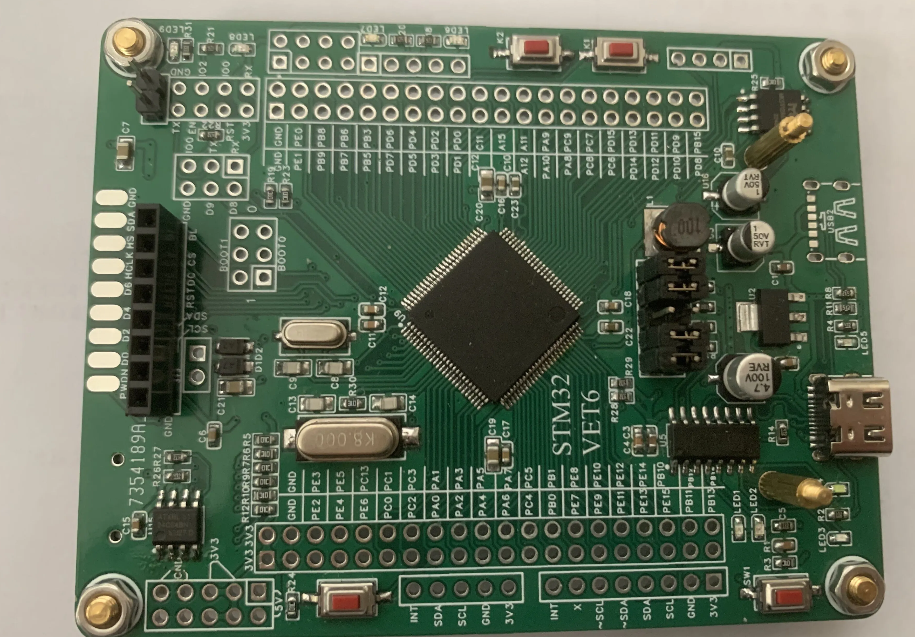

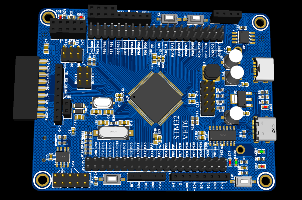

STM32F407VET6 Development Board
The STM32F407VET6 chip, with onboard W25QXX and AT24CXX modules for easy future expansion, features a 2.4-inch LCD display for GUI development, and
exposes pins for OLED display, ESP8266, NRF wireless module, MPU6050, etc., facilitating future development and learning. It also integrates an OV7670 camera interface, which can be used to learn about STM32's DCMI peripherals.
Innovations: 1. Onboard WCH-link using the CH459 chip, enabling SWD debugging and serial communication with only a single Type-C cable;
               2. Integration of multiple modules for easy learning.
The WCH-link download/debugging interface, LCD interface, flash, and EEPROM have been verified; further verification will be updated here…
This project can be used as a reference; any issues with the board are welcome to be pointed out by experts!
