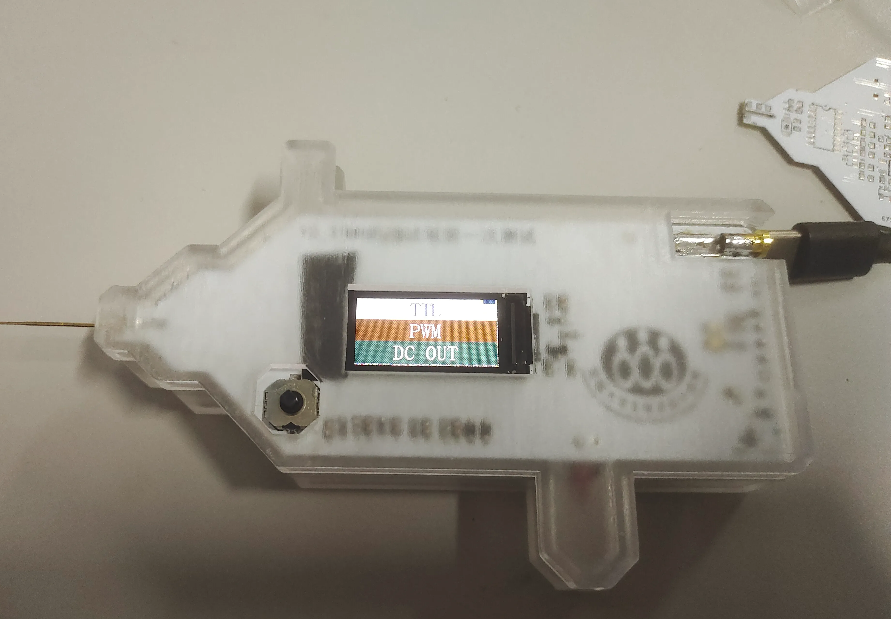

CW32 test pen
I'm a complete novice when it comes to replicating He Diangong's CW32 test pen
, and I kept running into problems. I had the same issue last time I participated in a Renesas clock-related event. Fortunately, the experts in the group provided guidance and helped me complete the replication. This time, I encountered many problems, such as the screen driver not working, the charging module overheating, and the chip not downloading. With the help of the experts in the group, I solved them one by one
. 1. For the screen driver issue, first check the soldering quality for any cold solder joints or incorrect soldering. Then, use a multimeter to check for short circuits. Mine was short-circuited due to improper soldering,
causing the screen not to light up. 2. The charging chip, TP4057, was overheating. Increasing the resistance in the PROG circuit reduced the current, and the chip naturally stopped overheating.
3. For the chip download problem, first carefully read He Diangong's documentation, and then connect the wires correctly in the programming settings as described in the documentation. If you have time, watch the official CW32 videos on Bilibili; they are very comprehensive and support domestic 32-bit microcontrollers.
Thanks to JLCPCB training camp.
I redesigned the PCB without modifying the original open-source schematic. It's important to separate analog and digital grounds. When designing the board, consider how to solder and test it after it's installed. Include extra test holes to prevent accidents. Also, during soldering, check for short circuits after soldering a section.
I highly recommend replicating the test pen. You'll learn a lot during the replication process, and the pen itself is very useful – it's excellent!

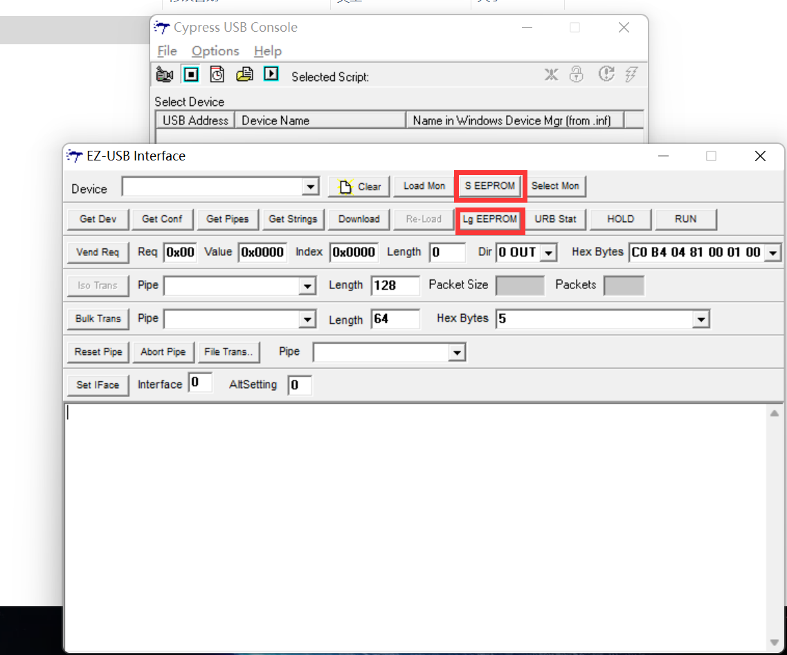

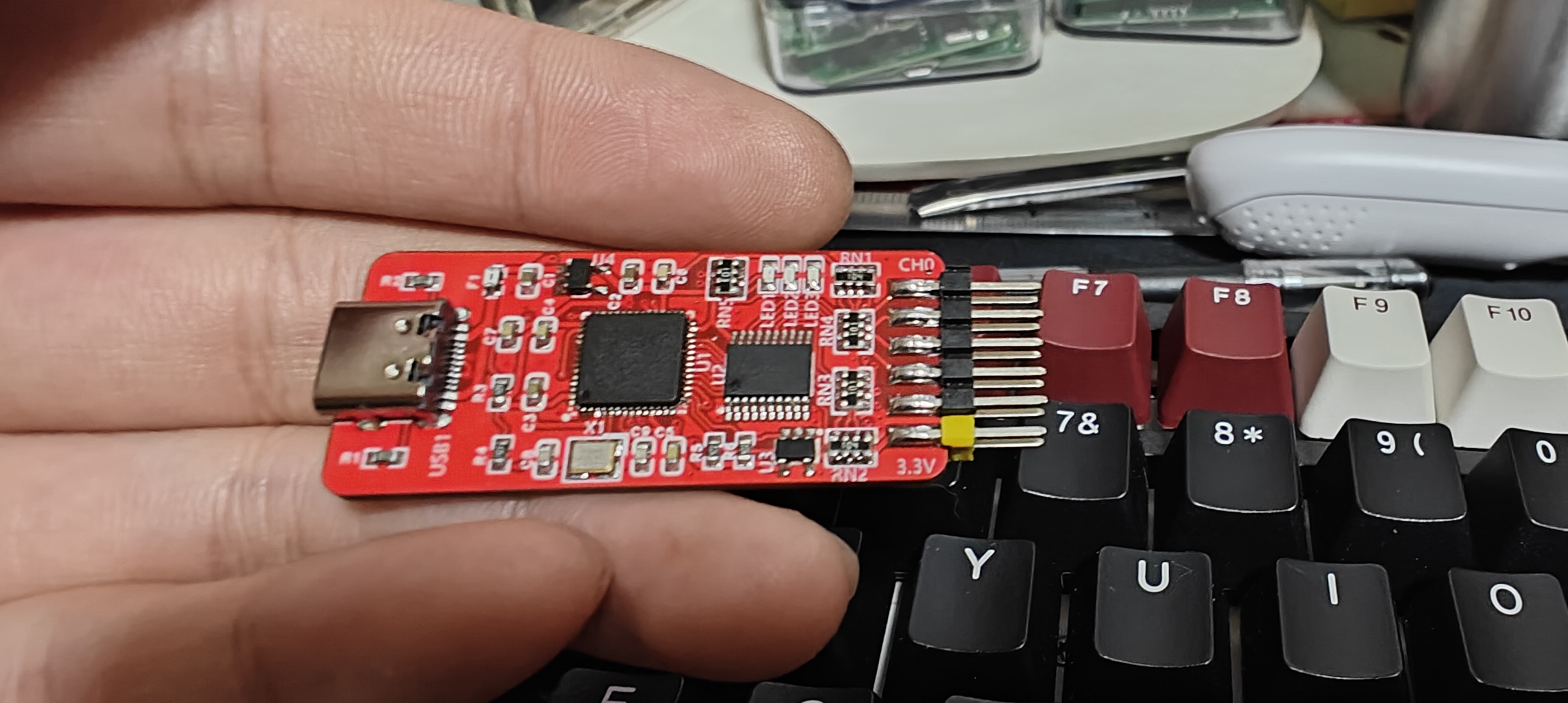

CY7C68013 Logic Analyzer - 20*45 copy_0603 RC version
Replace all the 0805 resistors and capacitors in the original design of the CY7C68013 logic analyzer (https://oshwhub.com/Starry/luo-ji-fen-xi-yi) with 0603 resistors and capacitors (I had extras on hand).
When soldering the CY7C68013, whether it's a disassembled chip or a new one, it's best to tin the pins (I soldered it twice, but it still didn't work when plugged into the computer, so I even bought a new chip online). Apply solder paste to the pads, use a hot plate or hot air gun, and apply solder paste to any bridging areas with a soldering iron.
The dimensions are 20*45 cm, which is quite noticeable compared to the size of a palm.

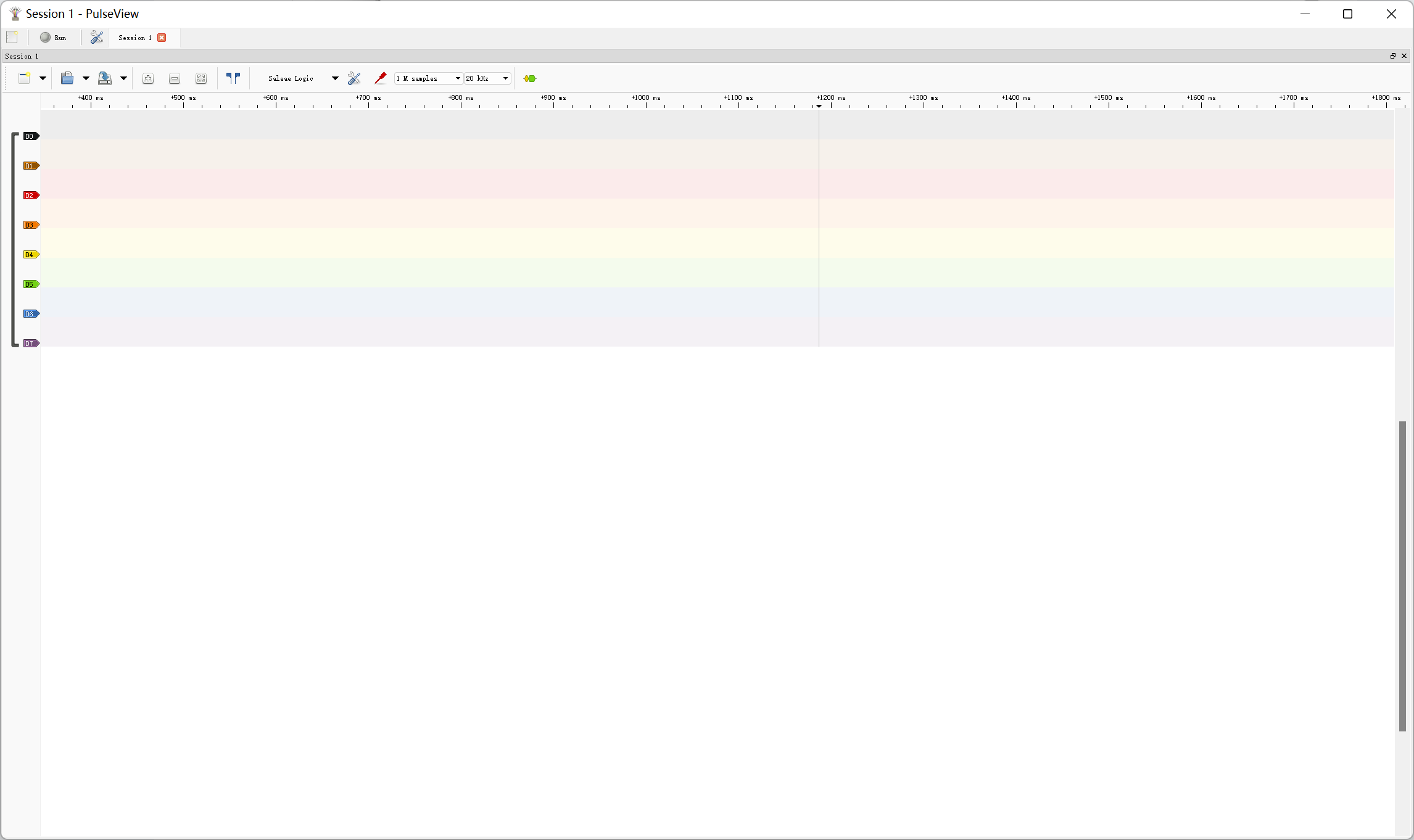

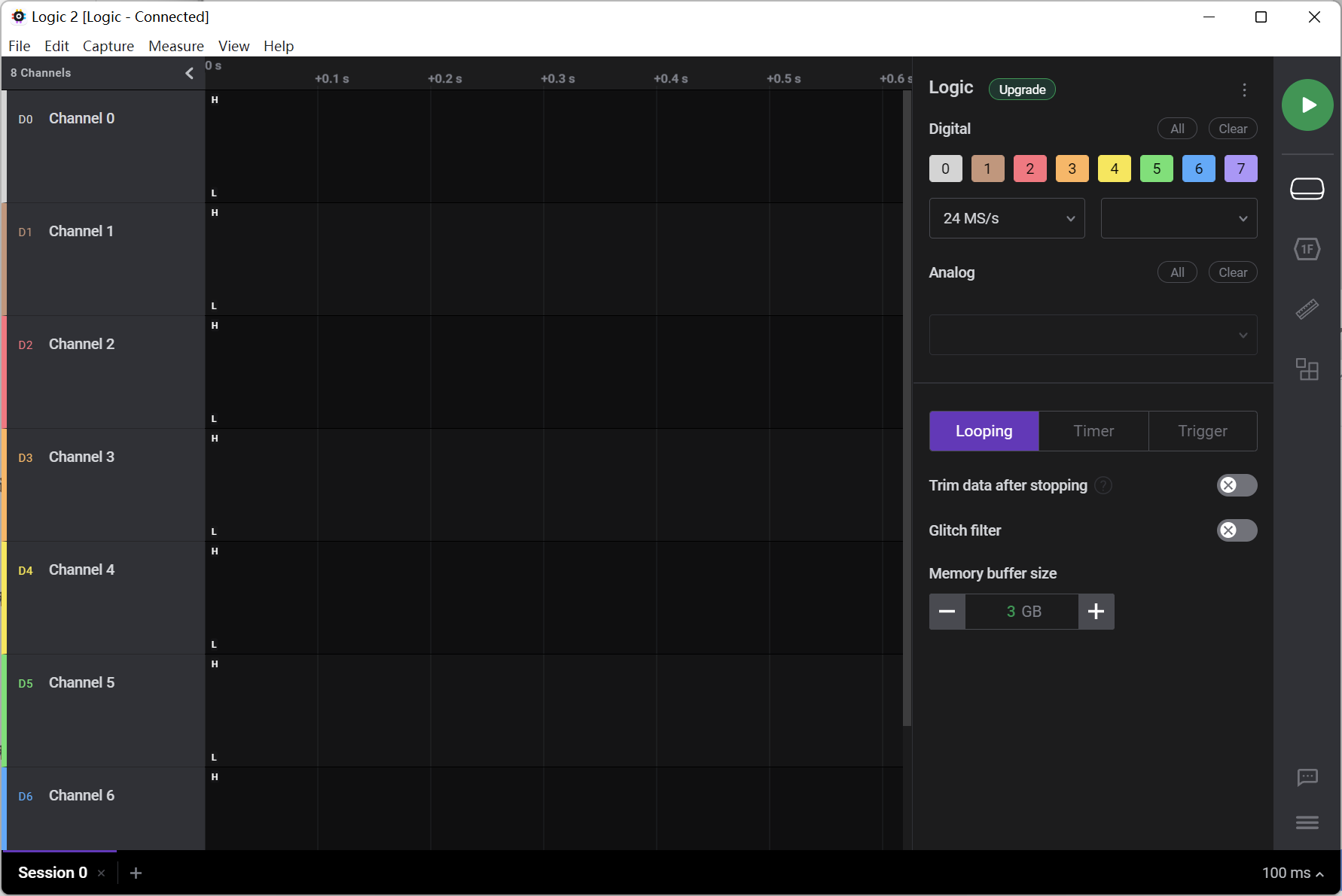

After connecting, install the driver (you can install as administrator by right-clicking). Open CyConsole.exe, click Options to open the EZ-USB interface, click S EEPROM, and select the saleae.iic file to burn. If using a larger capacity EEPROM, click Lg EEPROM.
Download the burning software here: PulseView saleae.

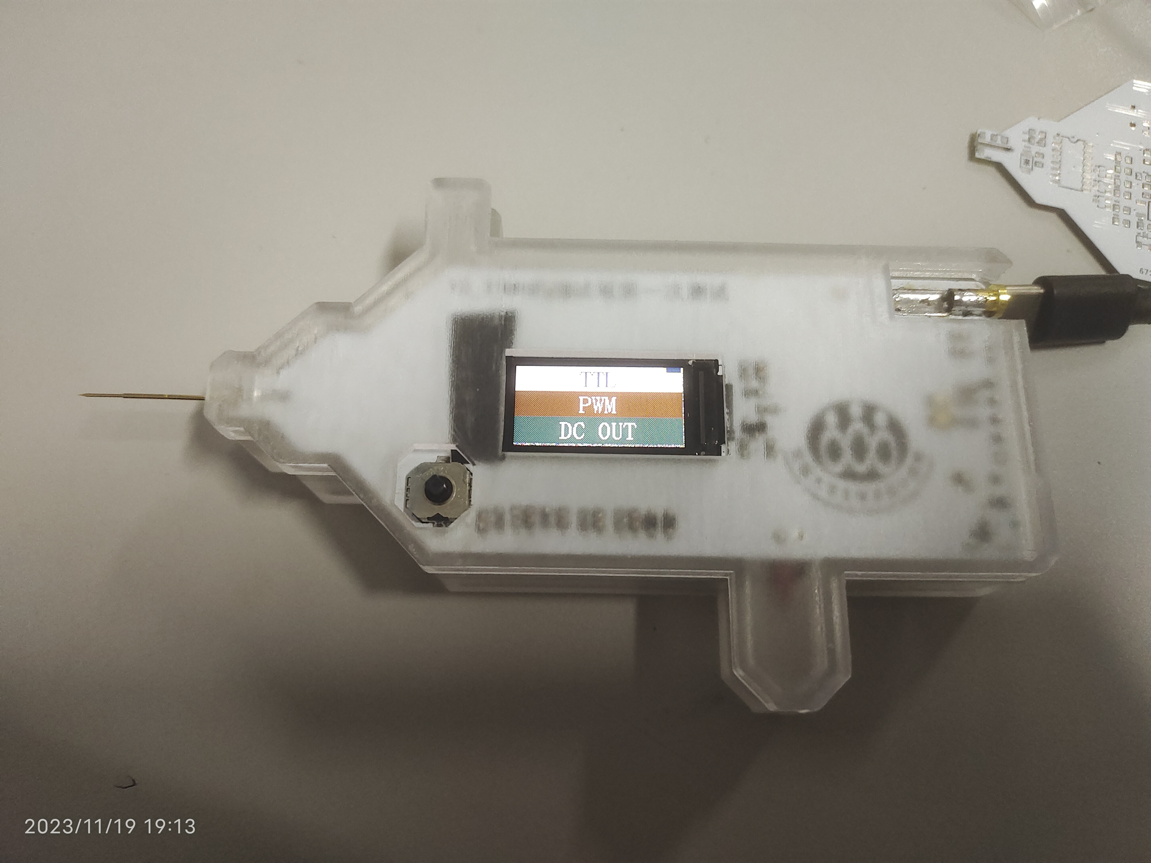

Multifunctional test pen
This multi-functional pen can be used to measure resistance and output PWM waveforms.
A portable multi-functional test pen with voltage measurement, continuity measurement, diode detection, and signal output functions was built based on the CW32F030.
This pen is a minor modification of the official design.
1. Main controller: CW32F030C8T6
; 2. Charging circuit:
This multi-functional pen uses a TP4056 power management chip to charge the battery (the official solution uses TP4057)
. Since there are many TP4056 power management chips available, the TP4057 was not used;
3. Power supply for the analog section;
4. Schematic diagram
(front and
back) .
