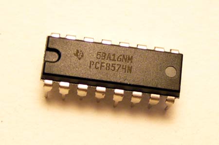

In this tutorial, you will learn how to build a simple serial 16x2 LCD display controlled via an Arduino board using only two wires. The underlying principle is implemented using the PCF8574 chip, an I/O expander that communicates with a microcontroller using the I2C protocol. The PCF8574 is a quick and easy solution for expanding and adding output/input ports to an Arduino. This chip connects to the standard I2C bus and adds eight additional output ports. A total of eight LCD displays can be connected to the same two-wire I2C bus, each with a different address.

The PCF8574 is an 8-bit I/O port expander that uses the I2C protocol. This protocol uses a two-wire serial interface for communication, with one wire for serial clock (SCL) and the other for serial data (SDA). Using this IC, you can control up to eight digital I/O ports using only two ports on your Arduino board. In the I2C protocol, each IC has a unique address; for the PCF8574, you have a 3-bit address, allowing you to connect up to eight devices for a total of 64 ports.

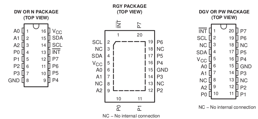

We can view the pinout of the PCF8574 in the datasheet:
Where: A0, A1, and A2 are address pins.
P0, P1, P2, P3, P4, P5, P6, and P7 are digital I/O ports (each is 1 bit).
SDA and SCL are I2C pins for communicating with the microcontroller.

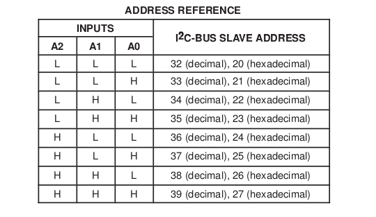

For the IC to function, an address needs to be set; this information can be found in the datasheet.
Where: L represents low level or 0V (GND), H represents high level or VCC
To define the addresses, set A0, A1, and A2 to your desired H or L. Remember that each IC should have a different address.

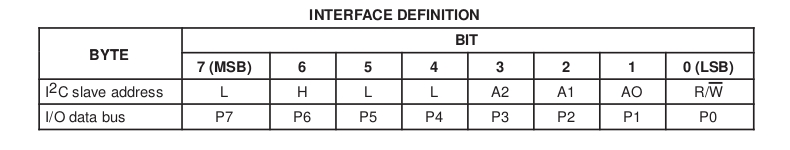

By examining the data interface, we can see how the I2C interface works on the PCF8574:
If you send an I/O data byte, it will turn the corresponding pins P1 through P7 on or off depending on the byte sent. For example, if you send the number 32, it will be binary 00100000, which will only turn on the P5 output. The same applies to reading; if you receive the number 32, it means that only port P5 is open at that time.
