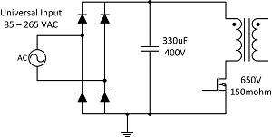

Designing a power supply to operate over a "universal input range" (85-265 VAC) can be useful for certain applications that are brought to different regions, such as mobile phone chargers or laptop power supplies. Many manufacturers want the convenience of a universal input supply so that they can reduce product variation and component count for sourcing purposes; however, using a separate supply can prove to save money.

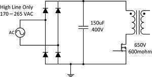

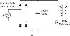

For example, consider a 250W power supply that does not require PFC. Each of these power supplies has a unique configuration that allows it to operate within its specified range.
A power supply designed for high voltage will only need components with a higher voltage.

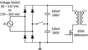

The universal input design must accommodate the worst of two independent power supplies; it needs to be able to handle the higher current of low-line operation and support the high-voltage requirements of high-line operation. A configuration using a voltage-selective switch has some benefits (lower voltage limit and lower current requirements), but there is a risk that the user will not put the switch in the correct state. It also requires twice the capacitance of a low-line-only configuration.
The input capacitor and main power switch vary in design based on the input range and driver cost. Other components can also benefit from the reduced range, such as the transformer, diode bridge, or electromagnetic interference (EMI) filter, but these primarily impact performance. The power level of the design also significantly impacts the cost difference. For a 5-10 W adapter for charging a mobile phone, the difference won't be noticeable. However, for a 250 W audio amplifier, the cost difference can be significant.

The evidence is clear: if a product isn't destined for use in multiple regions throughout its lifetime, it makes sense to use separate designs to cover each region. A universal input power supply is still required, but designers need to decide based on power level and portability to determine whether it makes sense. PFC requirements and the certifications required for different regions can also make the decision quite simple.
