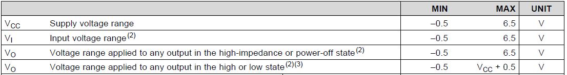

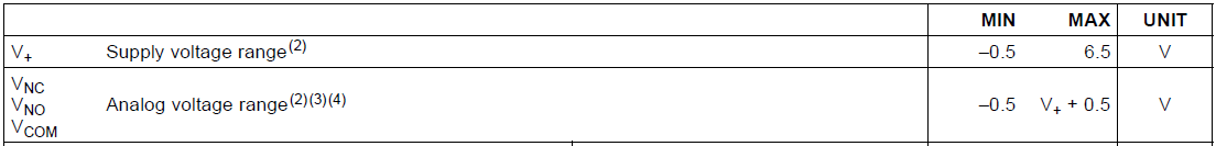

The Absolute Maximum Ratings table (Table 1) contains the answer.
Table 1: Sample Absolute Maximum Ratings Table
On this analog switch, we can see that the voltage on the I/O pin is not allowed to go above VCC or below -0.5 V. Therefore, we can conclude that there is a diode to VCC and a diode from GND on each I/O port of the device.
Figure 1: ESD diode structure of the device. The Absolute Max Table is similar to Table 1.
Table 2 provides another example where the absolute maximum rating is structured slightly differently.
Table 2: Example Absolute Maximum Ratings Table with Different Input and Output Limits
Here, we can see diodes from GND to both the input and output, and an ESD diode to VCC at the output. When the device is in the high or low state, there is a risk of current flowing through the VCC diode. The device has a special feature called a high-impedance state that prevents current from flowing back through the diode. It also has protection circuitry for when VCC = 0, called IOFF.
However, from the VCC + 0.5V statement, we know that there is a diode connected from the output to VCC, and that there is protection circuitry to prevent problems in certain configurations.
Figure 2: ESD diode structure for a device with absolute maximum ratings similar to those in Table 2
