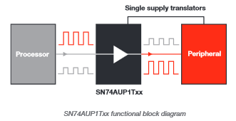

    Single supply converters are becoming an essential device on any board to connect two systems operating at different voltage levels. The input threshold of the conversion solution (V il , V ih ) should be within the output level of the driver (V ol , Voh) and similarly, the output of the solution (V ol , V oh ) should be within the valid input threshold of the receiver (V i , V ih ).
    Designers can implement the voltage conversion using either a single supply converter or dual supply converters.
    Examples of single-supply converters include the SN74AUP1T and SN74LV1T.
    How do I solve the problem of mismatched voltage levels between devices?
    Figure 1: Functional block diagram of a single-supply converter
    These devices have a single supply voltage that essentially tracks the peripheral supply voltage, as shown in Figure 1. The input ports have overvoltage tolerance, which allows them to act as step-down converters. Up-conversion occurs at compatible Vih - Vil levels relative to Vcc. The input signal must swing above Vih and below Vil for up-conversion to occur.

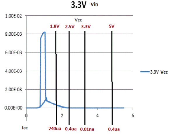

    Higher current consumption is always an issue when using a single supply converter for conversion, which becomes critical when operating in power-sensitive applications, as shown in Figure 2.
    Figure 2: Power consumption analysis
    The delta I cc spec in the datasheet is the difference in current draw for each input that is not on one of the rails. When Vin is about mid-point of Vcc, the delta I cc spec is highest, in mA.
