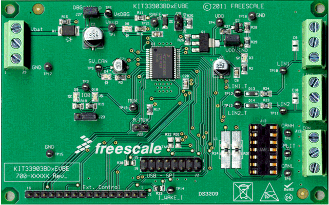

You can use this evaluation board to implement the functionality of the MC33903D3 system basis chip (SBC).
· Includes an I/O test point that you can configure to pull up to the VSUP voltage or pull down to the GND voltage with the help of resistors and LED indicators.
· You only need to install a jumper to test the SBC in debug mode
· Applied a separate terminal connector for powering the evaluation board from an external DC source
· Operated through a graphical user interface (GUI) that interfaces to the SPI dongle board ( KITUSBSPIDGLEVME ) via a 2x8-pin ribbon cable.
· For greater flexibility, you can apply a custom board with a microcontroller that communicates with the SBC via a 16-pin header
