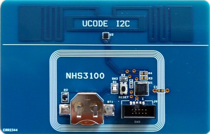

The solution consists of two NXP ICs, the NHS3100 NTAG SmartSensor and the SL354011FHK, which can be connected via I2C. NHS3100 control solution, operates the temperature monitor and forwards the status of the controlled goods to the Rain RfiD (UHF) interface. The recorder is configured and started via the NFC interface. All data can be read through NFC, and data can be uploaded to the cloud using NFC-enabled devices. Through the Rain RFiD interface, the package can be identified with the help of NFC ID and status indication can be given. This status information can be as simple as deciding to go or not to go, or it can be expanded to include more information. For example - the time of the event can also be displayed, depending on the firmware.
