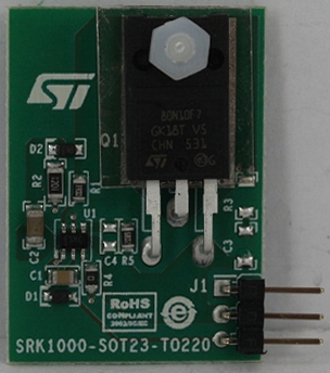

The EVLSRK1000A-TO is a demonstration board, designed for evaluation of the SRK1000A synchronous rectification controller.
The SRK1000A implements a control scheme specific for secondary-side synchronous rectification in flyback converters and provides high-current gate-drive outputs for driving N-channel power MOSFET.
The device can operate both in quasi-resonant applications and in fixed frequency (FF) mixed DCM-CCM applications. The board is provided with a setting suitable for QR applications. To use in FF applications, a 100 pF capacitor needs to be added in C4. A 68 kΩ resistor (R5) is provided on the TON pin that fixes the blanking after the turn-on to about 0.8 μs.
The board includes the SR MOSFET (TO-220FP package) and can be easily implemented into an existing converter to substitute rectifier diodes.
Main features
  • Synchronous rectifier for flyback converter, with fixed turn-on and adaptive turn-off
  • VCC range: 3.5 V to 32 V
  • DVS max. operating voltage 90 V
  • Max. frequency: 500 kHz
  • Internal gate drive for N-channel MOSFET
  • SR MOSFET type: STF80N10F7 (100 V - 10 mΩ) TO-220FP
