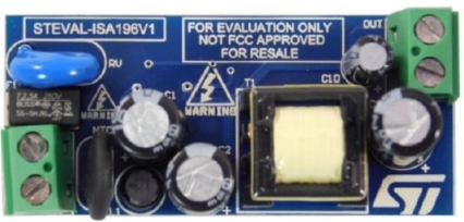

5V/1.2A non-isolated flyback converter using VIPerPlus-VIPer114LS
STEVAL-ISA196V1
The STEVAL-ISA196V1 evaluation board implements a flyback converter (5 V / 1.2 A) wide range mains developed for general purpose applications.
The core of the application is the VIPer11, a new off-line high voltage converter from the VIPerPlus family.
The device is a high-voltage converter that intelligently integrates an 800 V rugged power MOSFET with PWM current-mode control.
The main characteristics of the evaluation board are its single layer, small size and minimal BOM, high efficiency and low standby consumption.
Main features
  • Universal AC main input voltage range: 85VAC to 265VAC
  • Output voltage: 5 V
  • Output current: 1.2 A
  • Rated output power: 6 W
  • No load input power @230 VAC:
  • Active mode efficiency: > 78%
  • EMI: according to EN55022-Class-B
  • RoHS compliant
