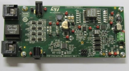

3.3V/6A, Synchronous Flyback Converter, Power over Ethernet (PoE) - IEEE 802.3at Compliant Reference Design
STEVAL-TSP009V2
The STEVAL-TSP009V2 is a reference design for a PoE+, high-efficiency, 3.3 V - 6 A flyback converter based on the PM8803 PoE controller.
The PM8803 is a highly integrated device embedding an IEEE802.3at-compliant powered device (PD) interface together with a PWM controller and support for auxiliary sources.
The STEVAL-TSP009V2 reference design is based on an isolated flyback CCM converter featuring synchronous rectification with gate driver transformer.
Main features
  • IEEE 802.3at compliant PD interface
  • Works with power supplied from Ethernet LAN cables or from local auxiliary sources
  • Line input voltage range: 40 VDC to 60 VDC
  • Output voltage: 3.35 VDC ± 5%
  • Output current: 6 A
  • Peak-to-peak output ripple:
  • Efficiency DC-DC full-load: > 90%
  • Overall peak efficiency: > 87%
  • Transient response ΔVOUTPK-PK to 50% load step:
  • ΔV in load line case:
  • RoHs compliant
