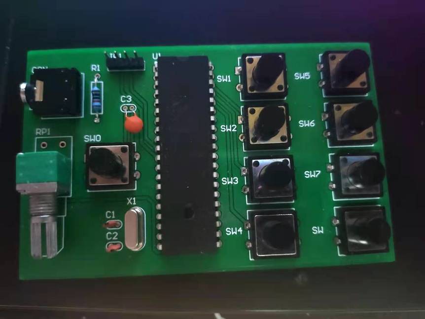

This design utilizes the key control of the STC chip and the principle of timer overflow interrupt control frequency to achieve the purpose of outputting square wave signals of different frequencies when each key is pressed. This circuit board can be connected to audio equipment with an AUX cable to achieve the output effect. Press the SW key to go up an octave, and the knob can adjust the output volume.
