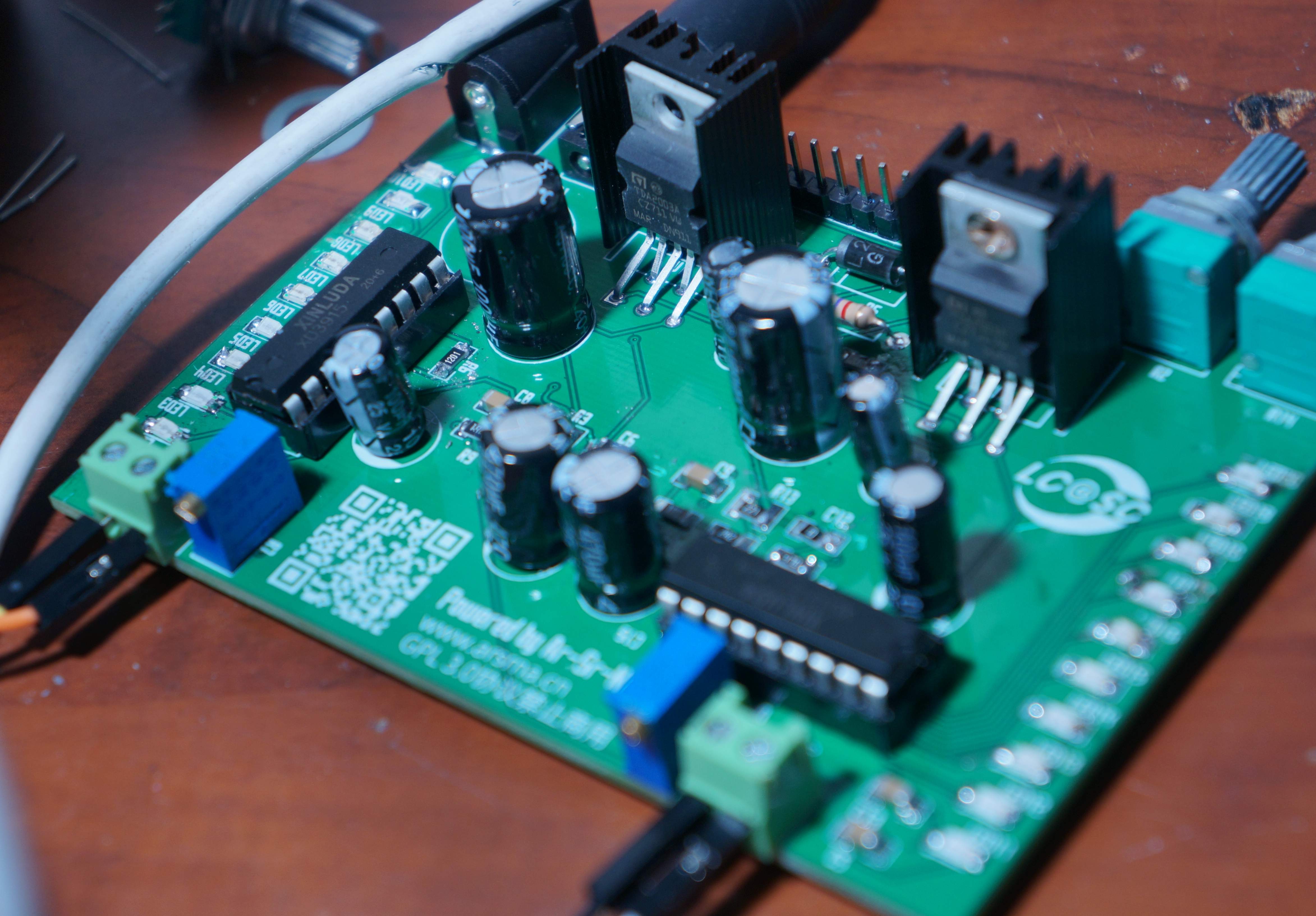

Amplify the input audio signal and apply it to audio and other equipment. You can also adjust each frequency band of the input signal to achieve a satisfactory listening effect.
See the equalizer: In addition to amplifying the signal, the LA3600 five-band audio equalizer
can also Music signal “visualization”
Using integrated IC, the whole circuit is very compact. The board size is 10*6cm and can be put in your pocket.

Input 12V power supply, can drive 10W speakers
Plug in the 9-18V power supply from the debug pin or power socket, plug it into the audio interface, adjust the volume of the input device to the appropriate level, and connect
the adjustable resistor next to the speaker adjustment port to control the sensitivity of the LM3915
This IC does not support volume adjustment, so it can be solved by directly connecting a potentiometer in series with the input end.
The non-inverting input terminal is connected in series with the signal with a 10uF filter capacitor to prevent noise.
The capacitor at the power supply end can achieve switching delay and prevent impact noise.
After this circuit is connected, the green LED will light up and will flash in color when there is a signal.

This is a set of simple power amplifiers and preamplifiers. The sound quality and fidelity are not comparable to high-end power amplifiers, but it can be used in operational amplifiers.
This project complies with the GPL3.0 agreement and is not for commercial use. It is only used for learning and education. Secondary creation is allowed, but after the second creation, it must be open source under the same agreement.
To make up for the audio shortcomings, LA3600 five-band equalizer chip is added, using DIP-16 package.
Its center frequency and sensitivity are programmable
wide voltage input, which can withstand 5-15 volts without error and output
high stability capacitive load.
