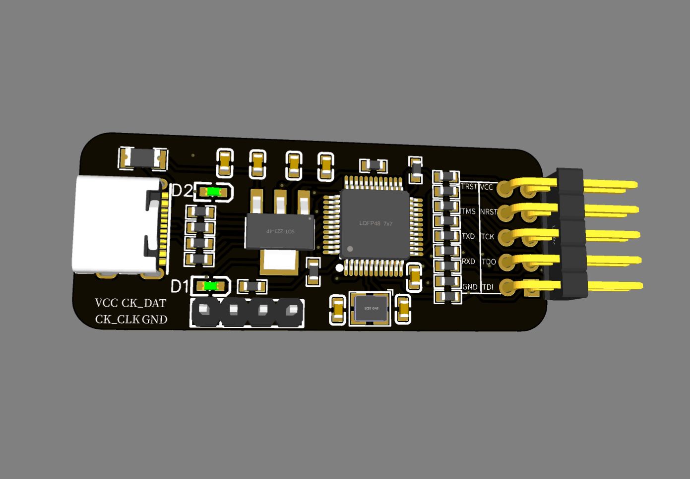

CKLINK is suitable for Hailink W800 series microcontrollers
CDK uses CKLINK to download and debug SDK
Hardware wiring
CK-LINK
W806
3V3
3V3
RST
RST (reset pin)
TCK
CLK(PA1)
TMS
DAT(PA4)
GND
GND
