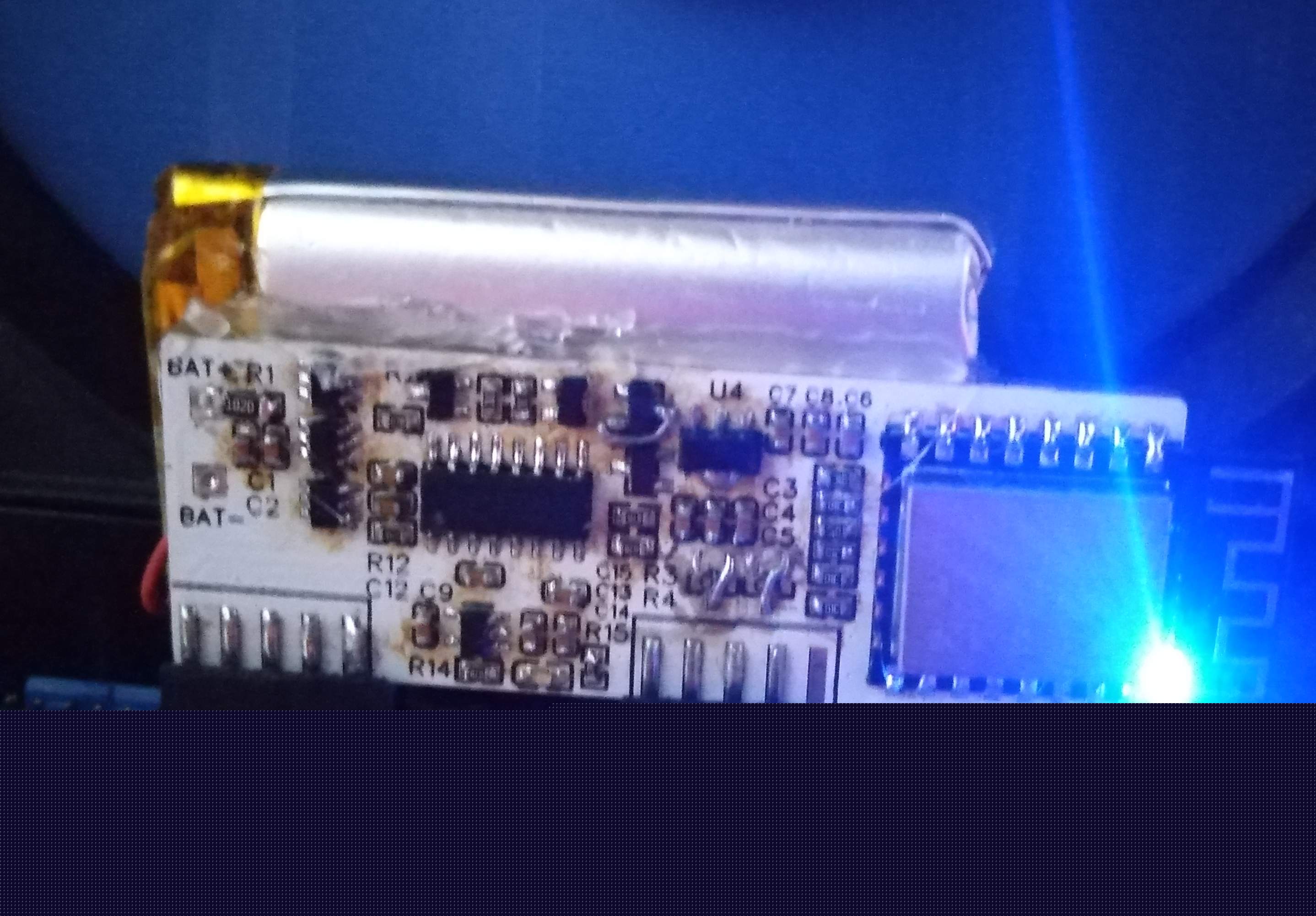

Remote boot card based on Blinker
This project is dedicated to SOYO's A88 motherboard. It detects the USB VBUS to determine the power-on status. The power on and off and forced shutdown are realized by pulling down the PANEL interface. Considering that there is no power supply after shutdown, battery power supply, charging, Protect.
The code has been open source https://github.com/panyihang/power-card
In 2021.3, the motherboard was replaced with a new one. The firmware stopped updating and only the most basic power on and off functions were implemented.
