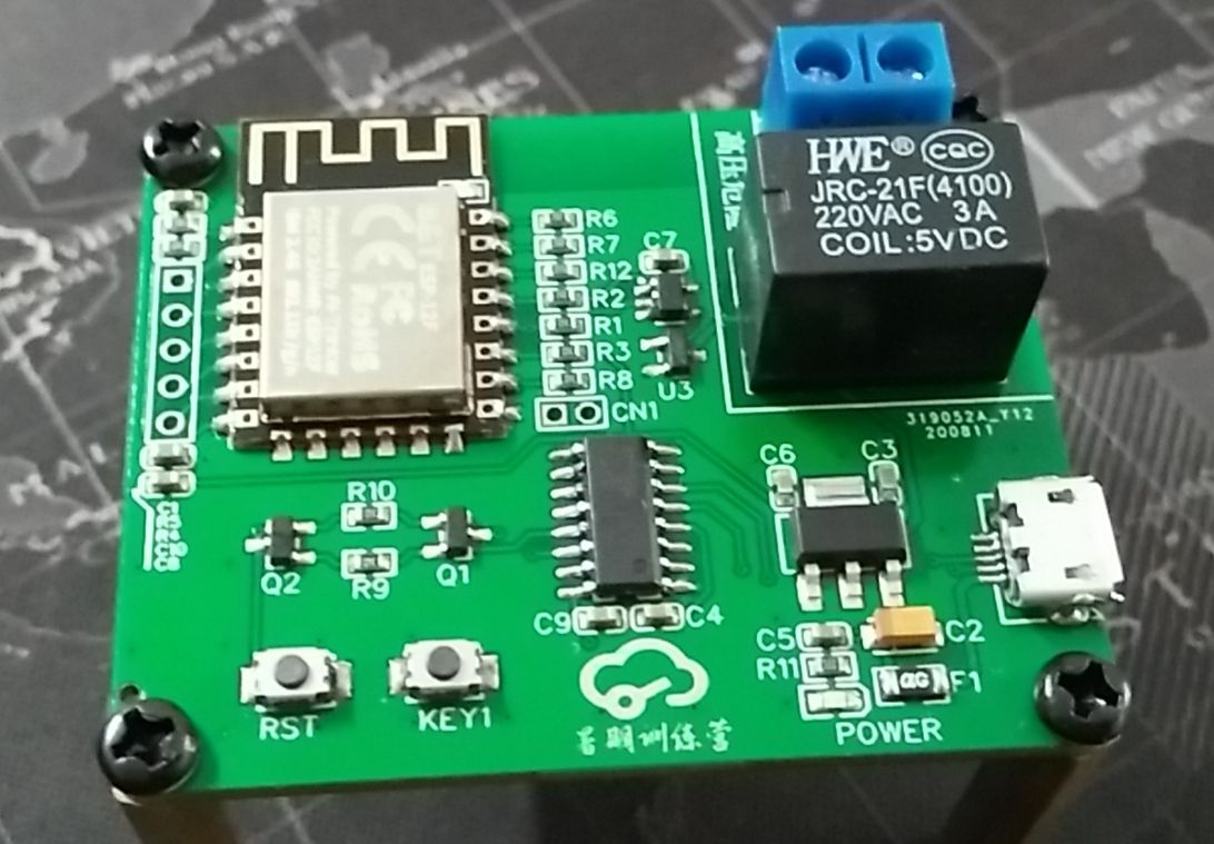

Smart socket test board based on ESP-12F
Function description
Access the Internet through ESP8266 to achieve remote control, and can be connected to Mijia to achieve voice control of Xiaoai classmates (Baidu Xiaodu and Tmall Genie cannot be tested because they do not have equipment, and theoretically can support the three major elves at the same time). There is a ch340 download circuit on the board, and it is designed with an automatic download circuit to facilitate programming and debugging.
designing process
1. Component selection
1. Choose ESP-12F as the main control. Supporting SOC can save PCB space and reduce circuit complexity. At the same time, ESP8266 supports arduino development, which can greatly reduce programming difficulty. Anxin’s ESP-12F (ESP8266 module) is also very cheap, so Choose ESP-12F.
2. The download part adopts CH340C, which has good compatibility, simple peripheral circuit and low cost.
3. The relay driver uses ON Semiconductor's inductive load driver NUD3124.
2. PCB design (omitted)
There is nothing much to say, just pay attention to the isolation of strong and weak electricity and the layout of the antenna .
3. Development environment
Developed using arduino IDE, using the library of Blinker, and building the arduino environment
blinker library file
Windows: Unzip the downloaded blinker library to the My Computer>Documents>Arduino>libraries folder
Mac OS: Unzip the downloaded blinker library into the Document>Arduino>libraries folder
After the environment is set up, select NodeMCU, as shown in the figure image.png
NodeMCU pin definition

4. Procedure
#define BLINKER_WIFI               //官方wifi协议库
#define BLINKER_MIOT_OUTLET        //设置小爱插座类库
#define BLINKER_ALIGENIE_OUTLET    //设置天猫插座类库
#define BLINKER_DUEROS_OUTLET      //设置小度插座类库
#define BLINKER_PRINT Serial       //串口协议库
#define BLINKER_ESP_SMARTCONFIG    //SmartConfig配网
#include <Blinker.h>

5. One-click network configuration
The SmartConfig distribution network used by the program can be used with AIRKISS , ESPTOUCH , etc. To access Mijia, you need to add it in Mijia-My-Other Platform Devices and bind your Dian Deng Technology account.
6. Use demonstration
The program has built-in voice control for three major elves (Xiaomi, Tmall Genie, and Baidu Xiaodu). Since I only have Xiaoai, I have not tested the other two. If there are problems when testing the other two, you can give me feedback. .
