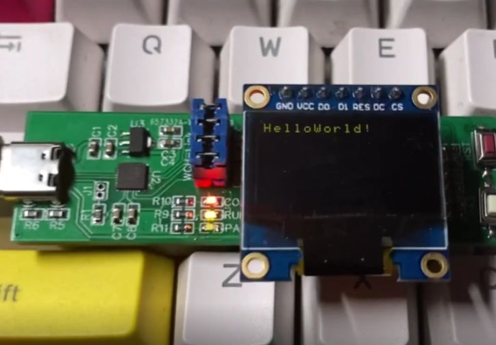

Use a small development board made by HK32F030MF4P6 to learn the transplantation of startup file link files and the preparation of cmake
This code is written using CLion and transplanted from the original keil environment to the gcc environment.
Tested functionality
  • GPIO(LED)
  • SPI (OLED screen)
  • Compile with gcc, download pyocd, and embrace open source
  • Onboard debugger for easy downloading
It comes with a gcc sample project of hk32f030m that I modified myself. You can open it directly with Clion and use it. Github link: kaidegit/testHK32_gcc: a temple of HK32F030MF4P6 for gcc (github.com)
