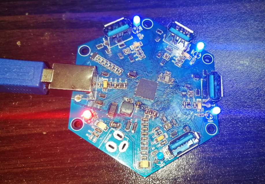

Functions: 1. Use USB3.0 square port male data cable to connect to the computer, expanding the USB interface; 2. There are power indicator lights and each interface indicator light; 3. Firmware can be downloaded to SPI, no need to power on every time The firmware needs to be downloaded manually; 4. The DC-JACK power interface is expanded, and 5V power supply can be input; Description: 1. Using VL812’s C69417 as the main control chip, it integrates 5V-3.3V and 5V-1.2V circuits, which can reduce peripheral circuit; 2. A common mode inductor and TVS tube are added to the USB3.0 interface, which are used for EMI filtering and anti-static respectively; 3. The 5V input has a fuse to prevent the circuit from being burned; 4. The PCB is designed with a regular hexagon corresponding to six Interfaces (1 power input, 1 USB input, 4 USB interfaces).
