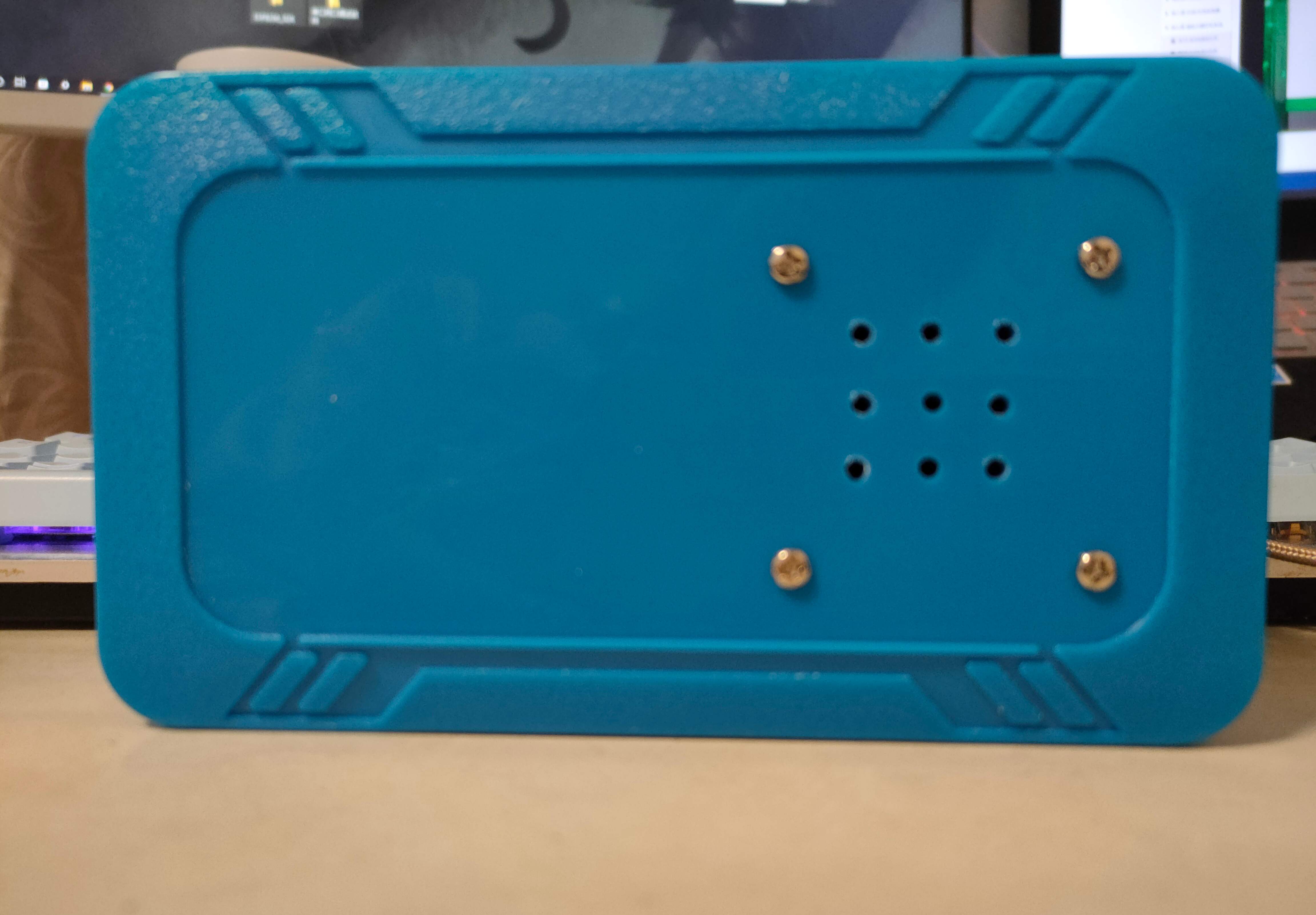

1. The main control part needs to be consistent with the IOT platform firmware configuration. After placing an order in the development-free way, the firmware cannot be modified. If you make an error, you can only fly the cable or change the board.
Firmware configuration
2. According to the chip manual, it has been tested and effective. Finally, an AO3401 was added to the back end to automatically switch to USB power supply when the USB is plugged in. If you use an old battery removed from your mobile phone like me, you can omit the charging chip and use D10. Prevent the battery voltage from flowing back into the USB interface and vice versa (currently the PCB is not added, you can change it yourself if needed)
Charge
3. For the LDO step-down part, due to the battery power supply, the star-level LDO AMS1117 is not suitable because the voltage difference is too high, so I chose a 500mv voltage difference one from Beiling (if you want to save costs, you can actually use a voltage regulator tube) Or resistor voltage division, the 3.3V here is mainly only used for function button input)
4. The module requires 5V power supply. Similarly, the battery voltage is not enough and needs to be boosted. Please refer to the chip manual for the circuit.
Boost
5. The design of the microphone speaker is based on the reference platform. For model selection, please refer to the attached information.
6. For infrared emission, we use six IR333-A infrared emitting diodes with a wavelength of 940nm , a forward voltage of 1.4V , and an operating current of 100mA . If you do not choose other infrared tubes of this wavelength, you can also
7. The infrared receiver uses 1 IRM -3638 (others in this series have been tested and are easy to use, such as: IRM-3638T-X) , which is used to receive 940nm , 38K modulated infrared signals. It has a built-in demodulation function and has a strong Anti-interference ability
