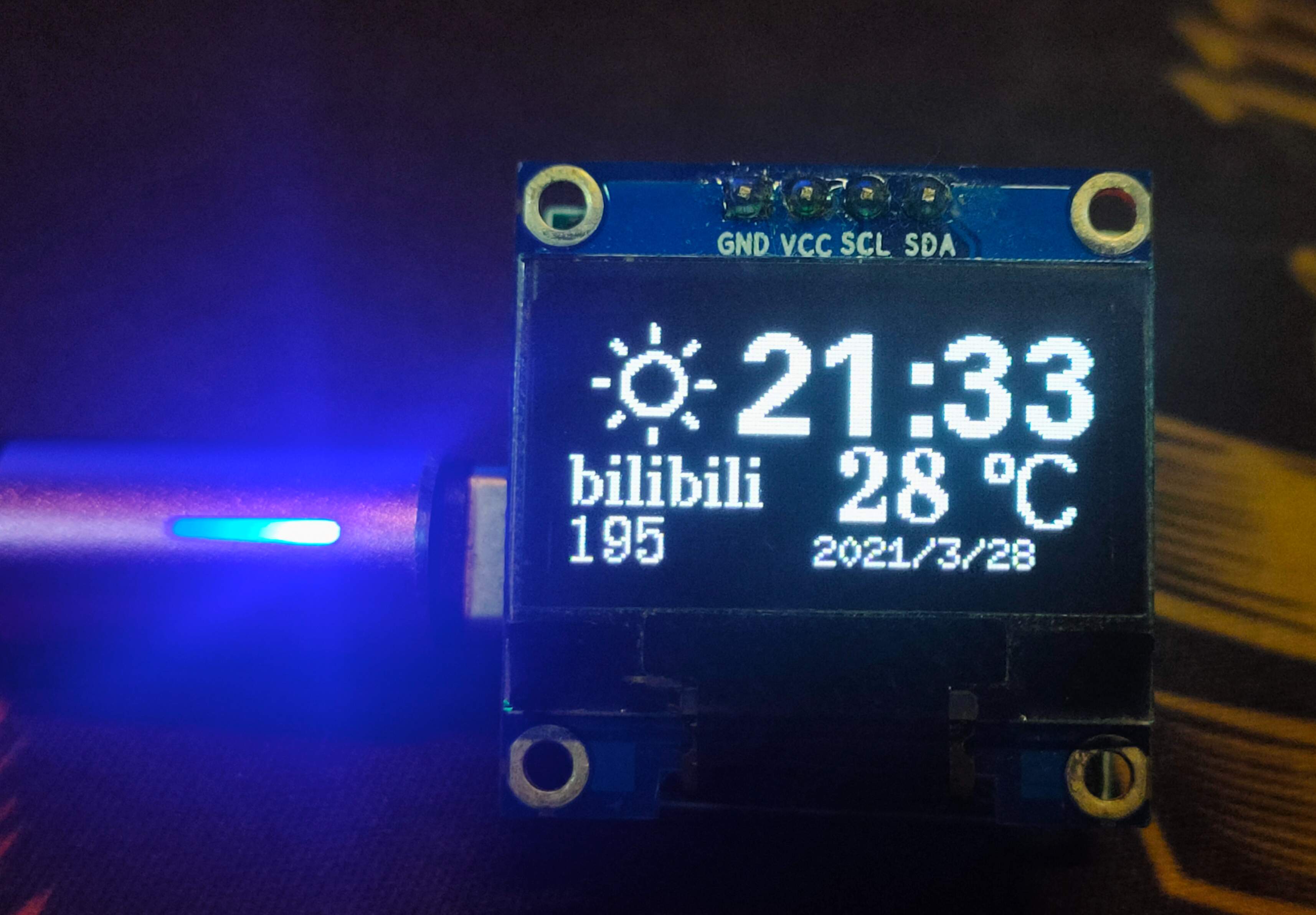

Use ESP01 or 01s, and a 0.96 IIC OLED screen. Pay attention to the OLED pin sequence of this PCB. Some pin sequences are different from mine, so be sure to pay attention! ! ! Be sure to pay attention! ! ! Be sure to pay attention! ! !
You can refresh station B fan display or weather clock.

Actual picture↓
