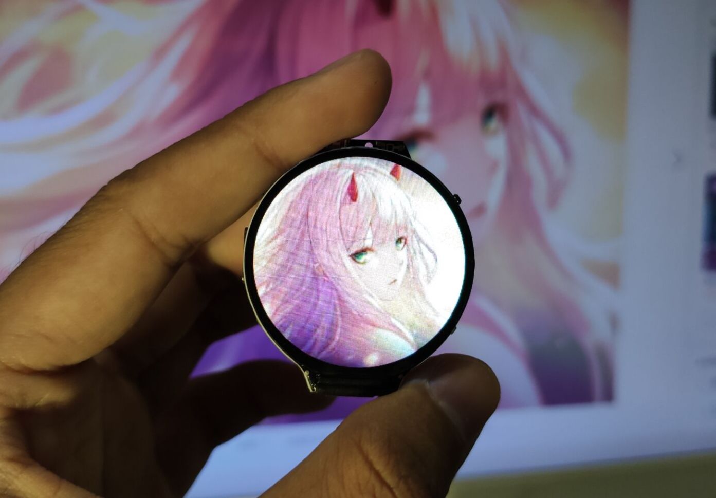

ESP32-PICO-D4 smart watch
Physical computer screen projection demonstration link: https://www.bilibili.com/video/BV1WR4y1H72X?share_source=copy_web
Thickness: without battery, screen 1.5mm, component height 1.35mm, pcb 0.8mm, total 3.65mm
Lowest power consumption standby mode: 34.5uA
The main power consumption comes from the DCDC chip (TYP17uA). If you are not short of money, you can choose a chip with lower static power consumption.

main part:
1) Main control ESP32
2) The screen is 1.28 inches round (without touch, why not use touch, because it is poor)
characteristic:
1.With vibrator
2.wifi bluetooth
3.UART+ automatic download
4. Ambient light sensing
5. Gyroscope, accelerometer
6.Lithium battery power management
7. Low static power consumption dcdc
8. Ambient temperature and humidity sensor
9. Four programmable buttons
10. The power enable of the screen, temperature and humidity sensor, and ambient light sensor are controllable
11. Power plug-in identification.
