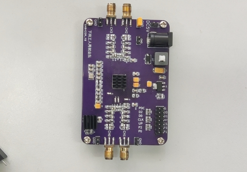

  1. The AD9959 board actually does not require much attention. Try to draw it as standard as possible. The key point of this chip is flexibility. It can be used to correct imbalance problems between signals caused by analog processing such as filtering and amplification or PCB layout mismatch. .
  2. The test pin of AD9959 is pin 17. When it is completely welded and powered on, the voltage of this pin is about 1.2V. Then the chip works normally. If there is a weak soldering or internal damage to the chip, the voltage of this pin is 0. (Don’t ask me why I know, I lost a piece of soldering and my 300 yuan was gone.) The package of this chip is LFCSP. Particularly easy to solder.
  3. When using microcontroller driver, SDIO_3 pin must be low level
  4. AD9958 and AD9959 common codes, the only difference is that two channels are castrated
  5. Our school only has 100M oscilloscopes. . . . . . . So the frequency range I set is 1Hz~99Mhz
  6. The peak-to-peak value setting of 1023 is already the maximum, and the output is about 508MV. No matter how high the setting value is, there will be no output.
  7. The peak-to-peak value will decrease as the frequency becomes larger
  8. The module cannot provide good load capacity, and a voltage follower needs to be added behind it. It is recommended to add AGC/VCA.
