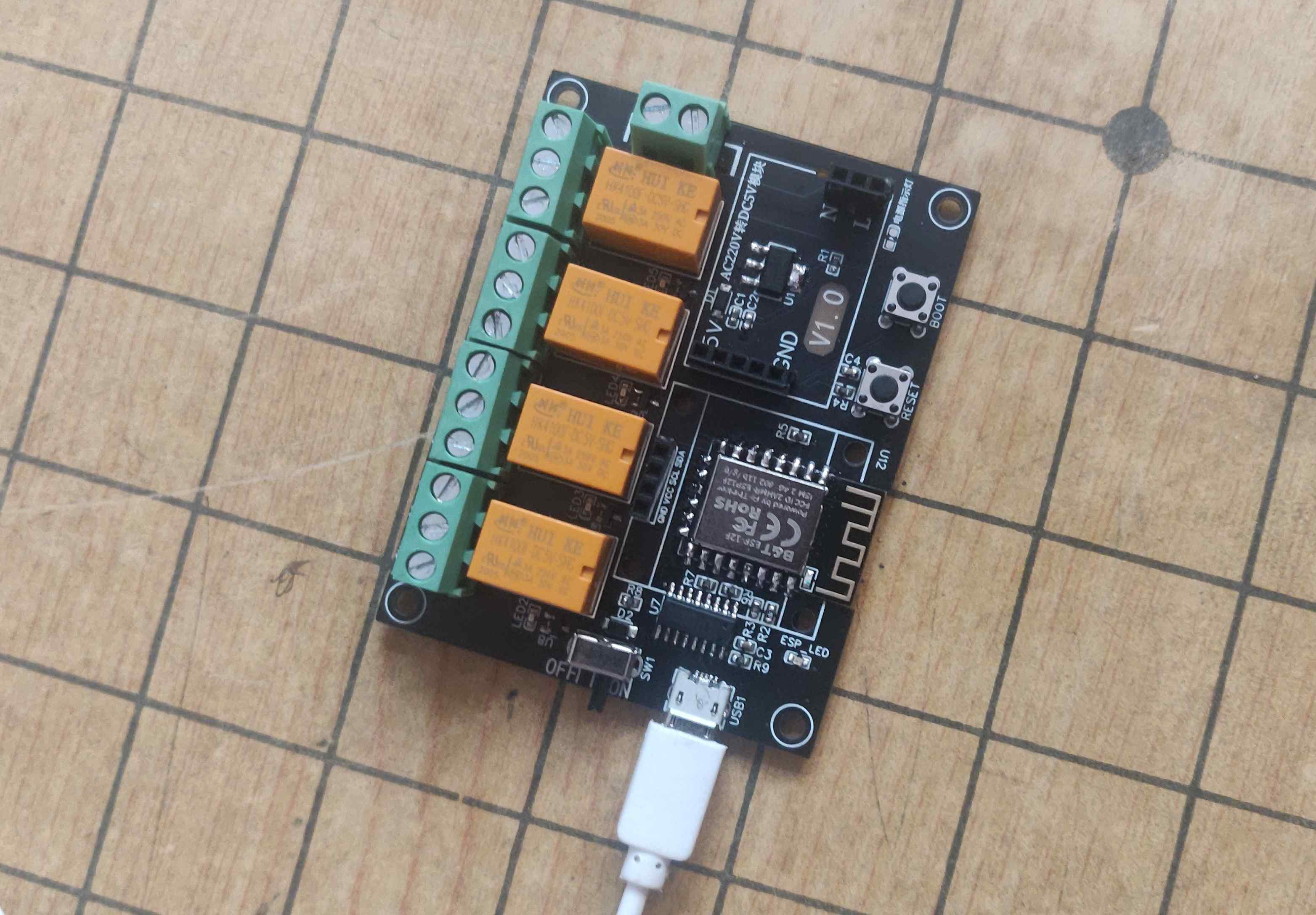

After disassembling the fan, I found that the principle of the electric fan is: Fan schematic diagram.jpg consider if the speed adjustment gear is screwed to the high speed when the mobile phone remote control is at low speed, that is, Fan schematic modification.jpg will there be an accident or danger? Because the internal motor speed adjustment principle is not very clear. I understand. After consulting the teacher, I learned that the internal speed regulation structure of the motor is as follows Reactor method.jpg
  • Therefore, when the relay is connected to low speed, if it is turned to high speed by hand, it will run at high speed and no danger will occur. (Then do it with confidence~)
After searching for information, I found that the shaking head function is not an electrical structure, but a mechanical structure, so the fourth relay is planned to be changed to a night light function. Internal structure of fan shaking head.jpg
  • During welding, I found that the 3D preview model of the terminal block was opposite to the actual model. There was no big impact, but the silk screen printing was uneven. . . Then the components are slightly misaligned and a little squeezed.
  • When connecting the data cable, I found that the MIC-USB I chose this time was not very strong after welding. I should choose another USB socket with a large horn socket.
Finished product display

I learned a lot about wiring layout through this training camp. Before, I just thought that DRC would be fine (haha). Place it randomly and route the wires at will. If you can’t get through, just make a via hole. If you can’t get through, just go around in a big circle. Later, I learned from Song Gong, Zhou Gong and other classmates in the group that USB should use differential signal lines. It is not necessary to lay copper on one side of the relay. It is best to dig a slot between the neutral line and the live line. If the welding space allows, weld the power supply device first, and then do a test. If everything is normal, weld the control chip and other devices. (Before, it was all welded together, and as soon as it was connected to electricity... it often overturned). I feel that this training camp is a transformation for me. From playing with building blocks by connecting various modules with bread lines, I now arrange all the required devices on a board reasonably and delete the unused ones on the previous modules. device, which not only saves space but also improves stability. One step closer to being a real design engineer.

Updated on August 25th. It was found that the pin is at a high level at the moment of power-on. Because the relay is also triggered by a high level, it will flash. To ensure safety, an inverter is added to each relay. Correspondingly, it is also necessary to change the program and adjust it to output a low level to meet the conditions. By searching for information, we learned that the instantaneous voltage level of the ESP-12F pin when it is powered on is as follows:
