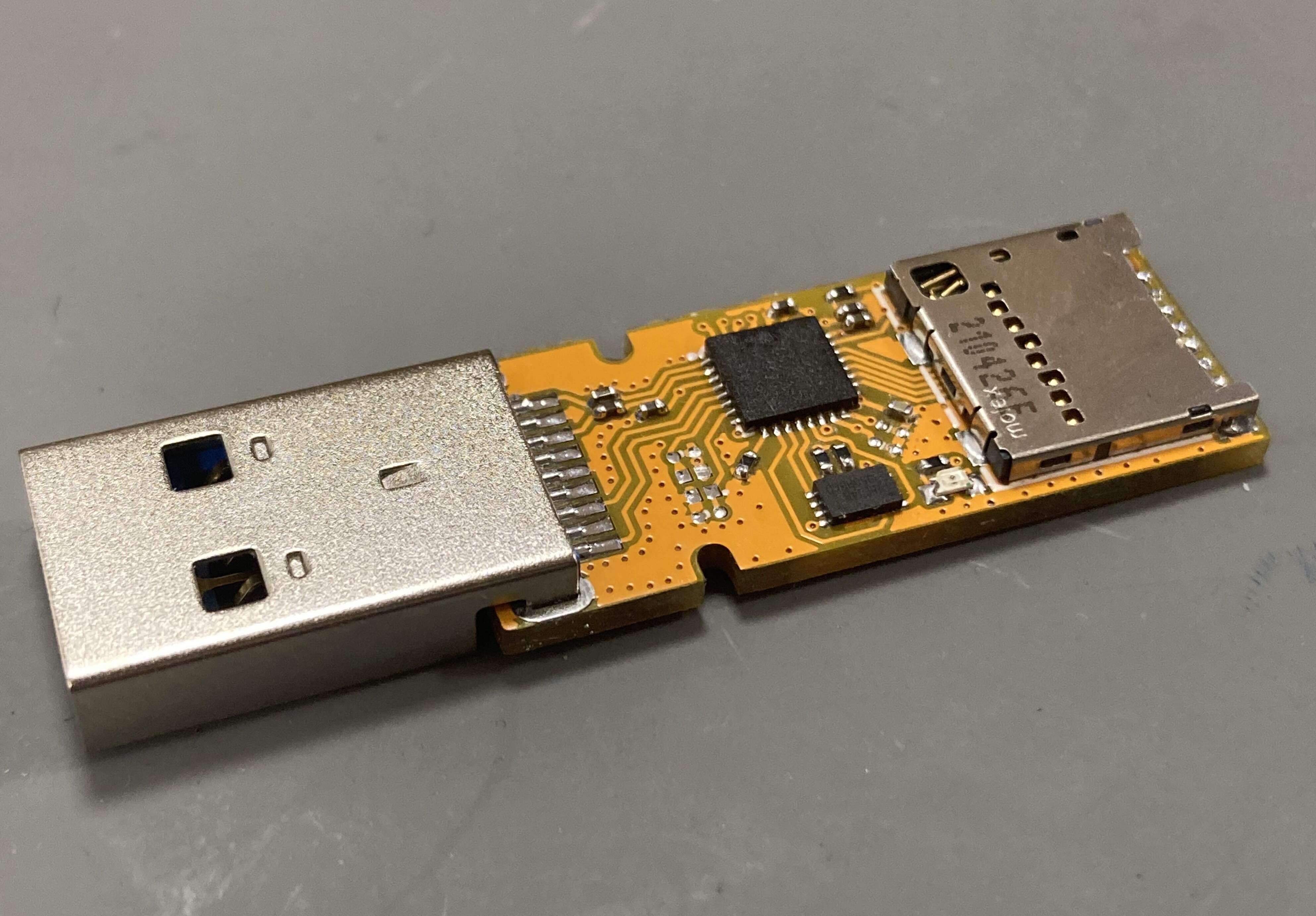

TF card reader based on GL3224, matched with Molex high-end card holder, G2 version.
Update the four-layer board and delete the flash chip. I don’t believe USB3.0 can’t come out QAQ
Found the problem, rubbish dismantling machine grinding disc oooooooooooooooooooooooooooooooooooooooh
Damn, why can’t USB 3.0 still work? It’s strange that USB 2.0 is intermittently malfunctioning.
It can be used, but why can't it shake USB3.0? ! ! !
