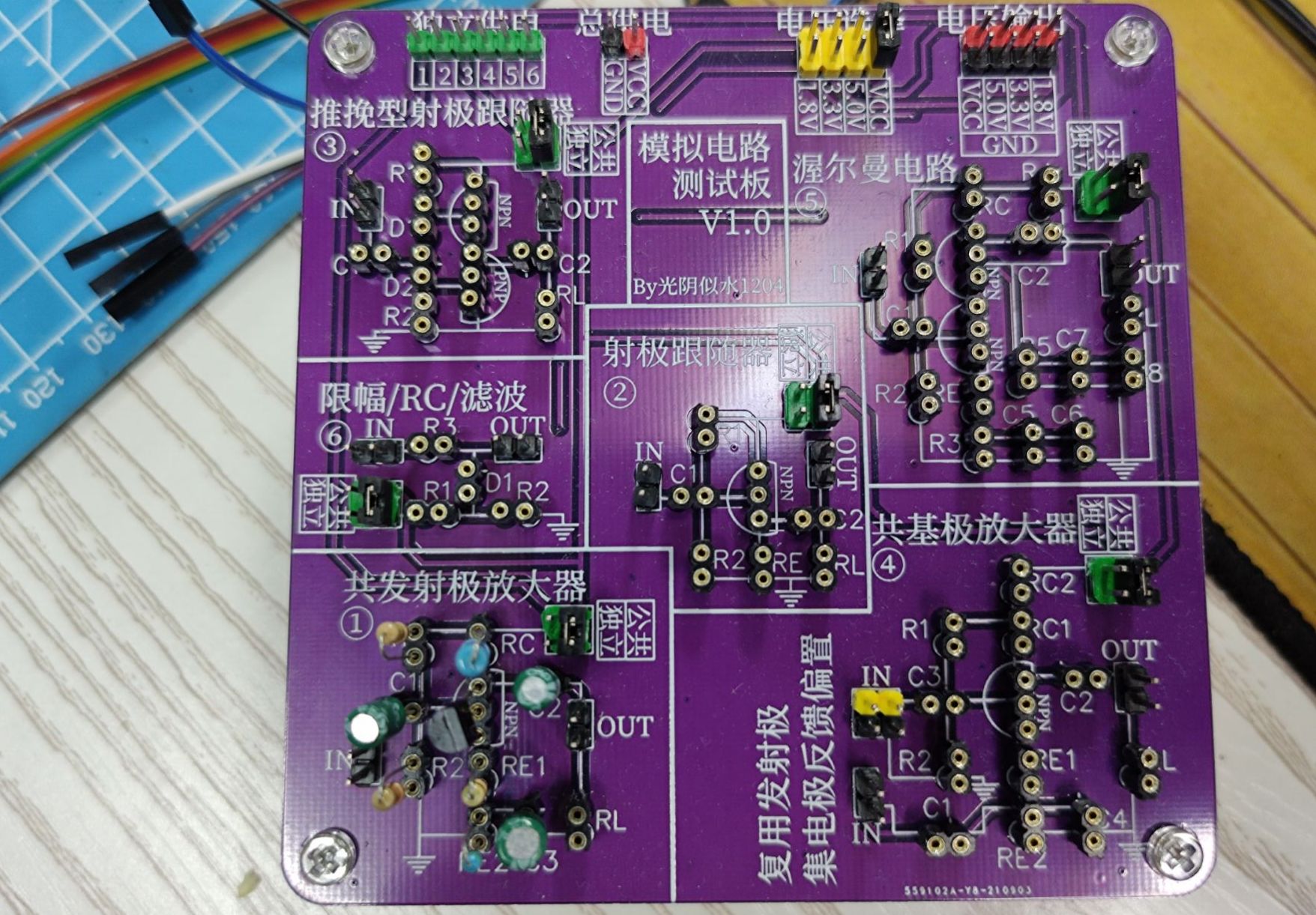

Update: Organized and labeled the schematic. The DC power input and power supply switch are added, and the packaging of the anti-reverse connection diode is modified. The version is V1.1
All components are pluggable for installation, making it easy to adjust parameters. Integrated LDO buck chip. It can provide 5V, 3.3V, 1.8V power supply voltage and an independent power supply interface.
It can realize the construction of triode common emitter amplifier, common base amplifier, emitter follower, push-pull emitter follower, cascade circuit, limiting circuit, RC circuit, filter circuit, etc.
Each circuit can choose between independent power supply and public power supply. The public power supply uses the output of the board's step-down chip.
Each circuit has a signal input interface and a signal output interface, making it easy to access a signal generator and oscilloscope for learning.
