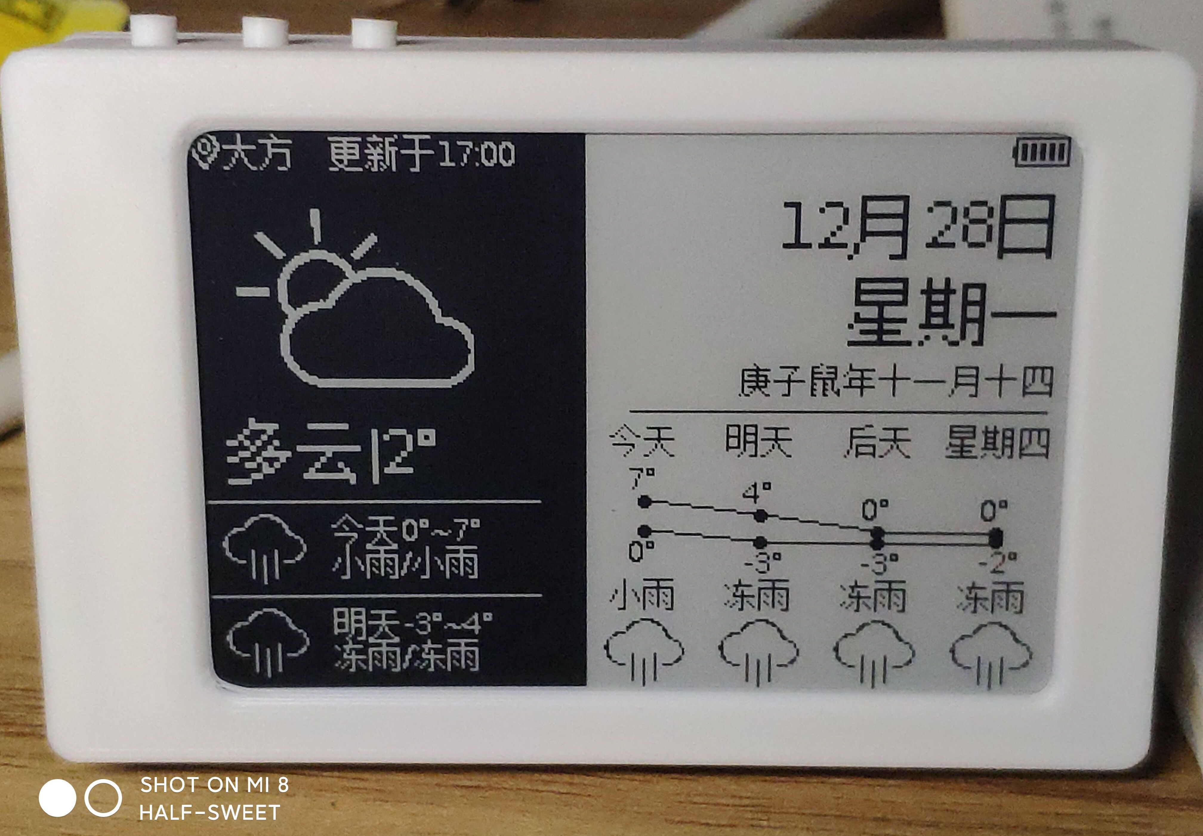

A clock/weather forecast station based on a 3.27-inch ink screen, supporting the following functions:
  1. Show today's and tomorrow's weather
  2. current time
  3. Indoor and outdoor temperature and humidity (outdoor temperature and humidity are obtained by the weather API, indoors are obtained by the sht30 sensor)
  4. Device battery
The supported screen is Weifeng’s 3.27-inch dual-color ink screen
Thank you @duck for your selfless help and firmware support
