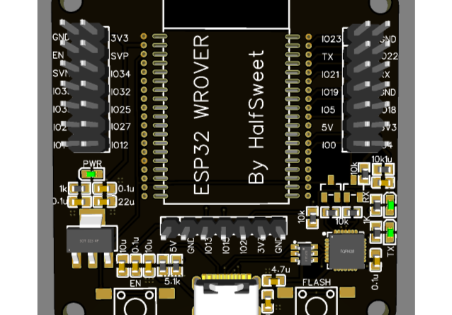

ESP32WROVER test burning socket (compatible with ESP32WROOM)
I have wanted to do this project for a long time, but I kept thinking...until I found that the test burning socket sold on Taobao was really expensive, and I was really poor, so I came up with such a project.
And there is a big problem with the products sold on Taobao:
  1. Only WROOM does not have WROVER, because WROVER is too long, so it cannot be inserted. This project is theoretically compatible with WROVER and WROOM, but the only drawback is that it lacks a few pins of WROOM, but if you simply burn it, there will be no problem.
  2. It actually uses MicroUSB! ! Now it has been changed to the extremely advanced Type-C (I believe
  3. Lead out all the pins and can be used as a development board
  4. An ESD diode is added to the USB to prevent static electricity from damaging the USB
ps: It has not been verified. I hope a friend (tool person) can help me verify it. Theoretically, there is no problem.
参考设计图片
