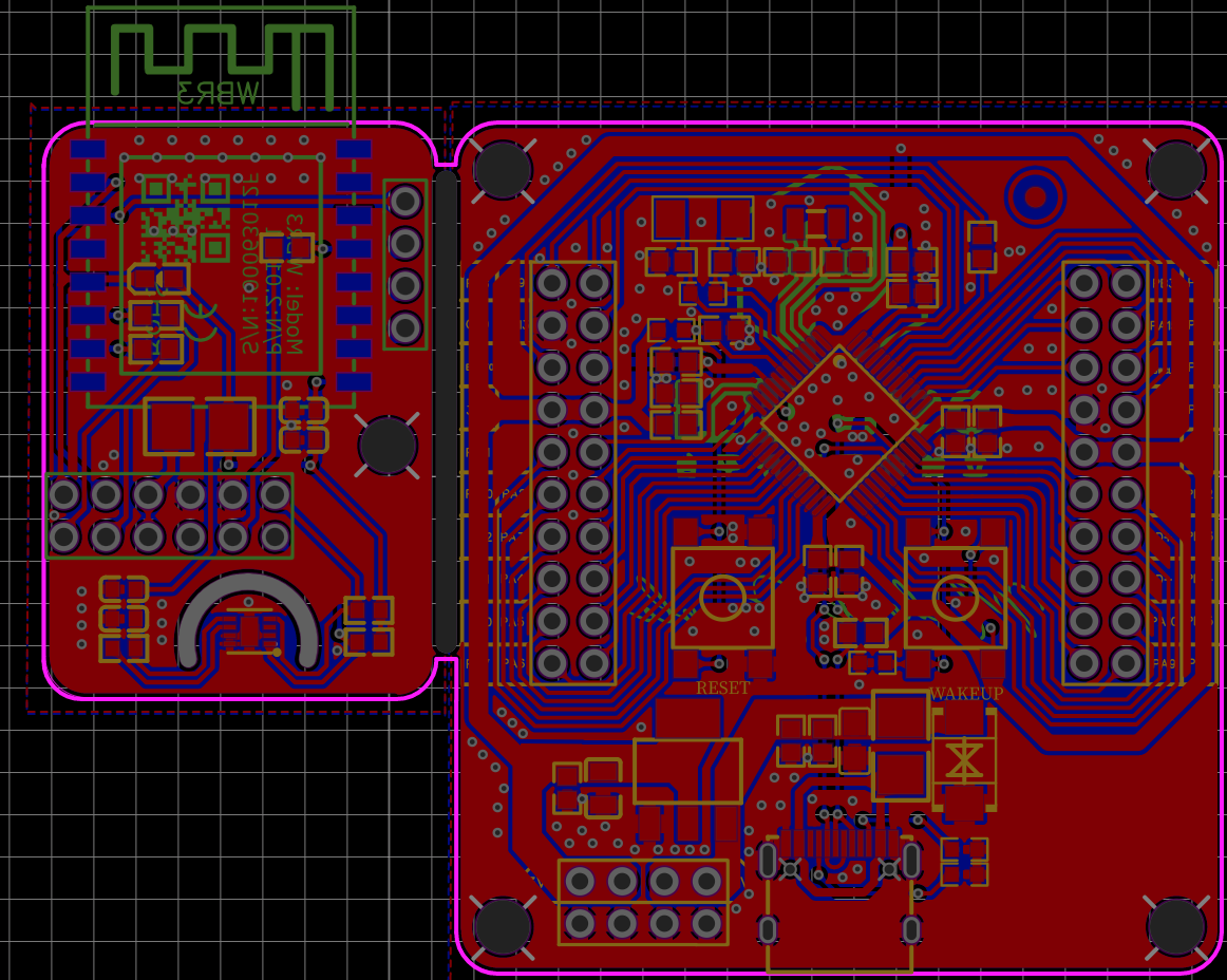

2. PCB design
PCB design adopts the form of minimum core board + expansion board. PCB board The left side is the expansion board. Connect BOOT0 to GND on the expansion board. HK32 can be booted from FLASH. There is also a Tuya WBR3 networking module and SHT30 sensor on the board, which can be spliced ​​to the development board for use or used on other boards. At the same time, there is a 0 ohm resistor pad left, and the module can be used alone. The right side is the core board. The components are compactly placed. The 3v3 power supply line width is 1.2mm to ensure the power supply of the chip. At the same time, on the D+ signal transmission line Pulled up with a 1.5k ohm resistor.

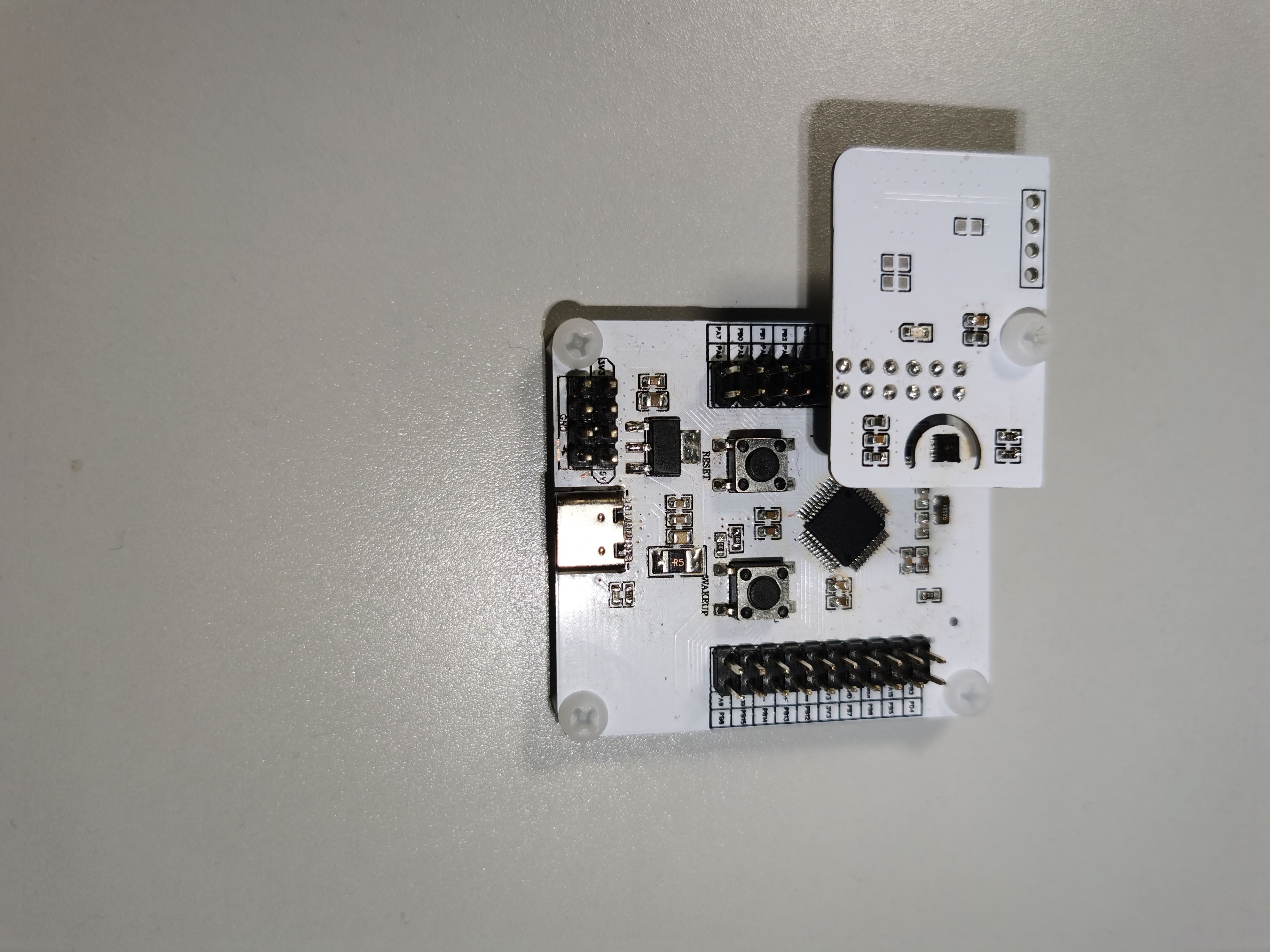

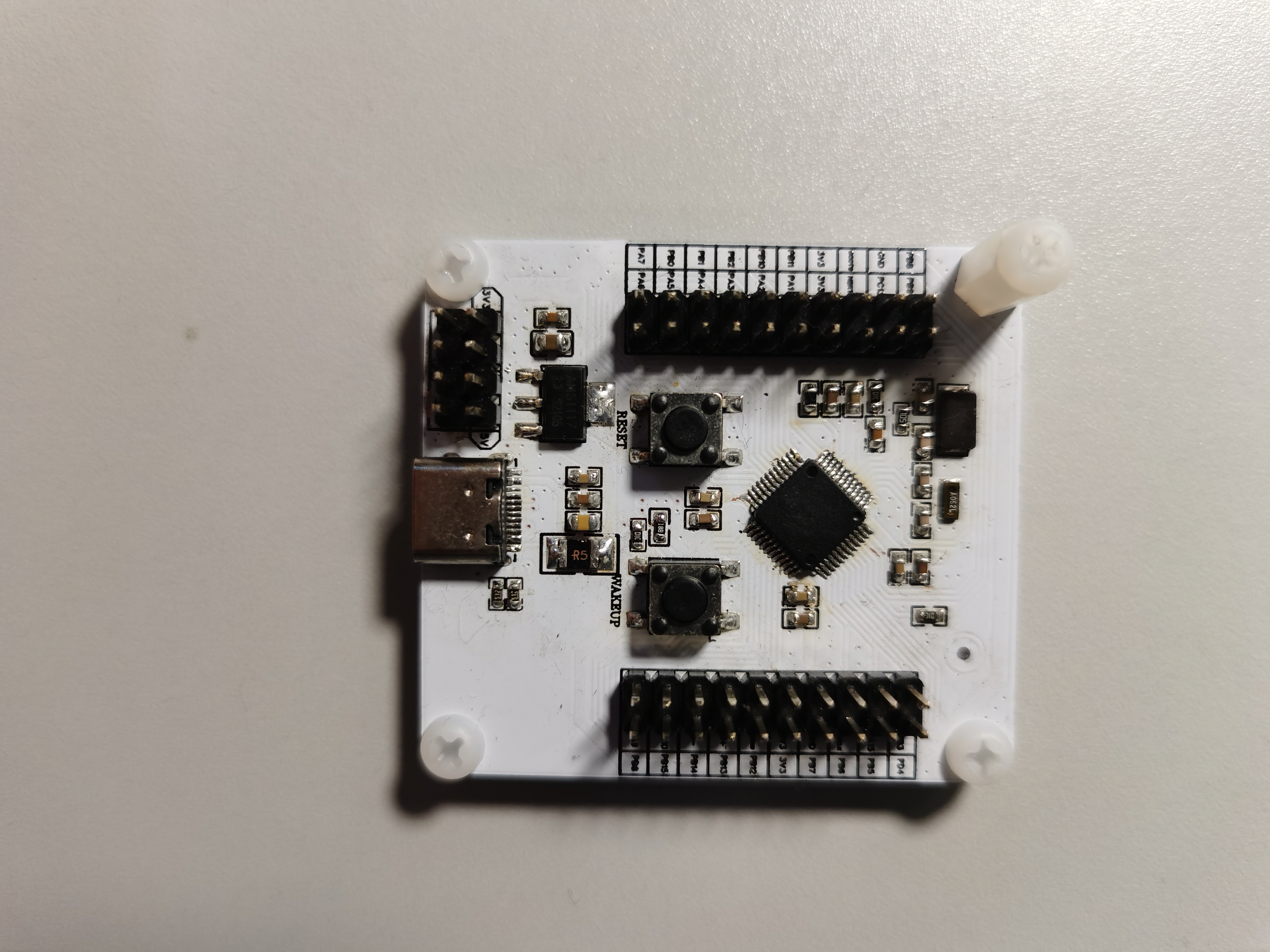

Soldered circuit board
Insert image description here

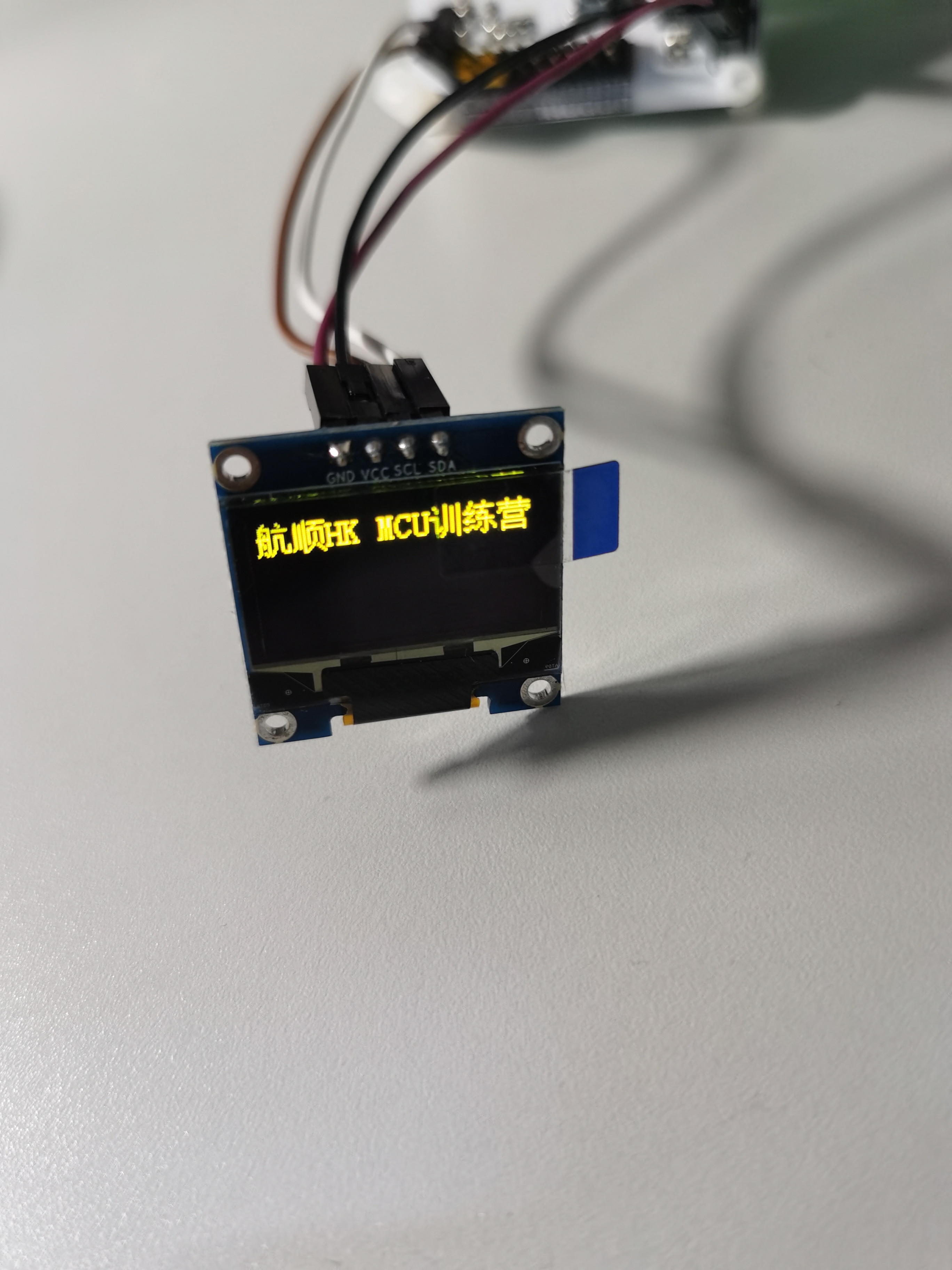

1. OLED display
Insert image description here The OLED display works fine.

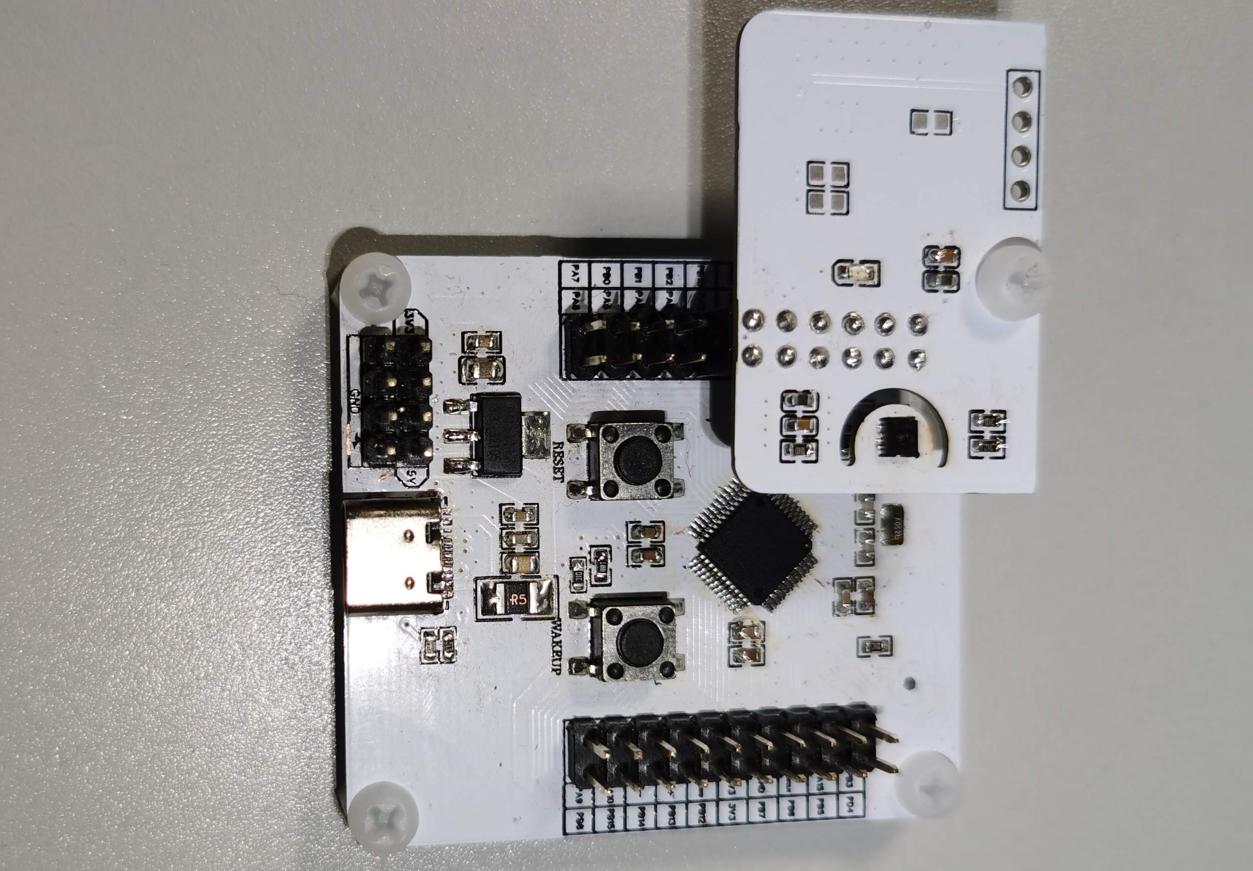

2. SHT30 temperature and humidity sensor
Insert image description here Since the pin issue was not considered during the design, the Tuya USART3 pin conflicts with the I2C2 pin, and OLED cannot be used to display temperature and humidity data. (Newbie Xiaobai, after making the board, I learned that the I2C bus can control sensors with different addresses. When the addresses are the same, they can be addressed by turning on and off power or transmission lines. Here, the SHT30 temperature and humidity sensor address (0x44), OLED (0x78), It can be controlled with the same I2C bus, you can try it next time) I will add later that IMG_20210330_224409.jpg the SHT30 temperature and humidity sensor works normally.

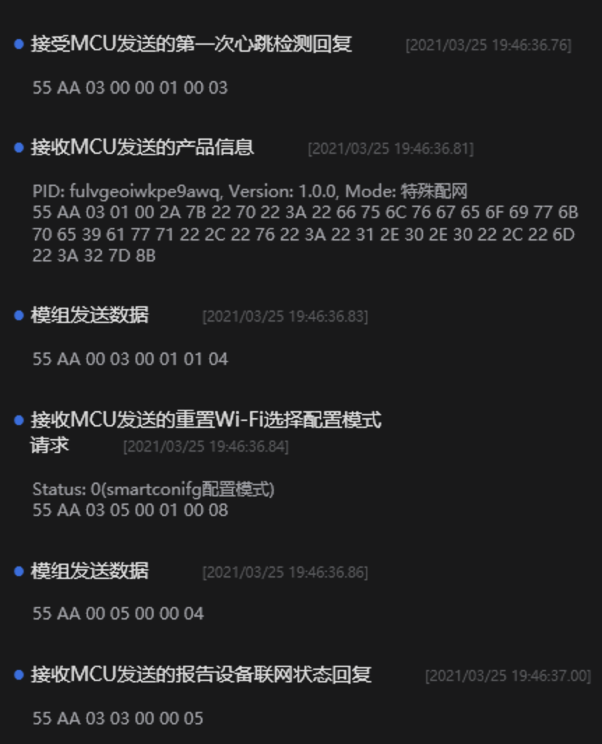

4. Tuya networking module

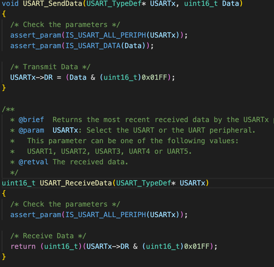

In the test assistant, the MCU has successfully configured the networking module, but since the module is still on the way, it can only be added later. Insert image description here By comparing HKF103 and STM32F103, we found that the USART data register of HK in the code is different from that of STM32. HK is a shared DR for Send and Receive, while STM32 uses TDR and RDR respectively. Similarly, the ISR of STM32 changes to SR in HK. You have to read and compare the library code to find out when the code is transplanted. Insert image description here
