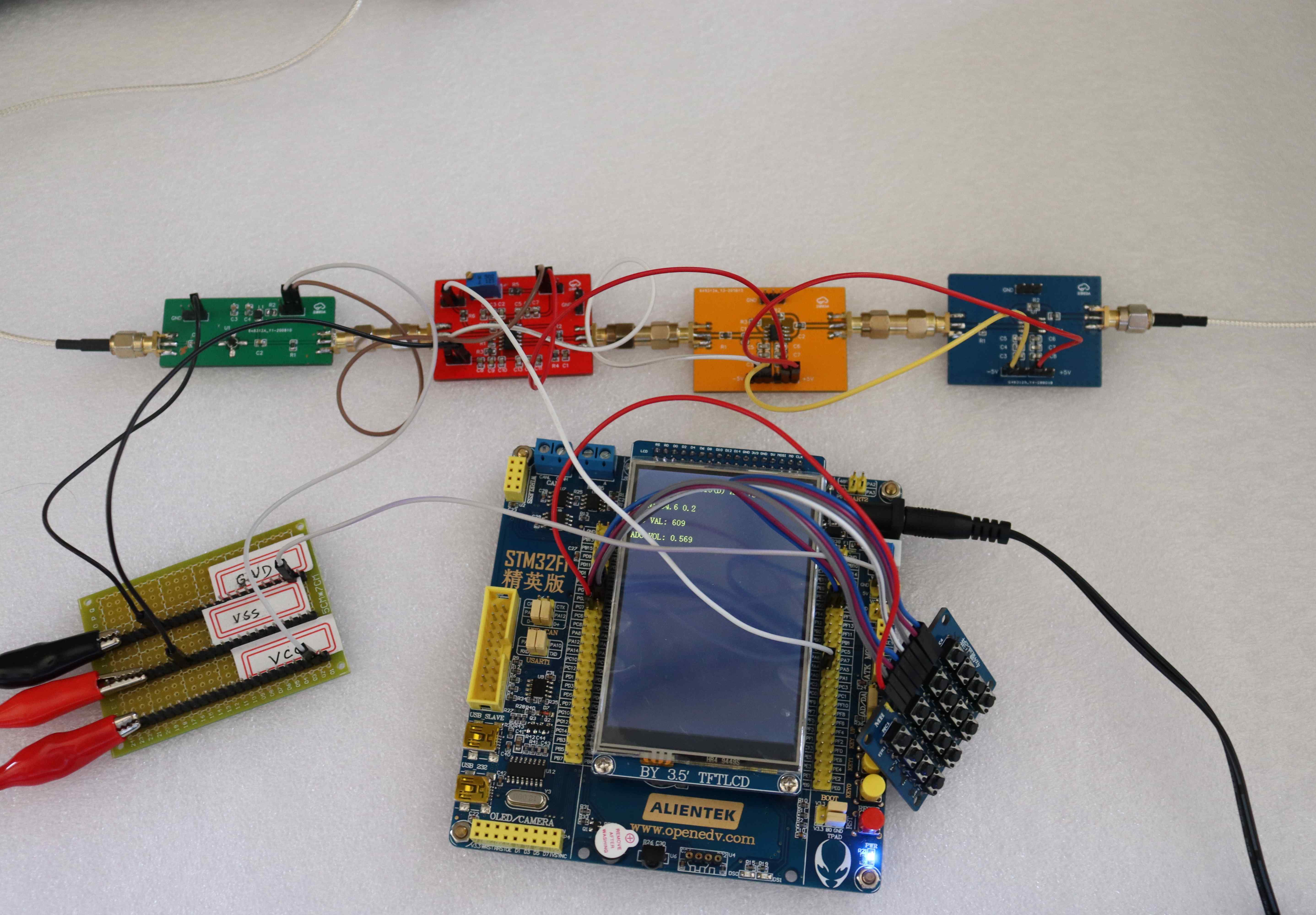

2. Design ideas
After analyzing the topic, it can be seen that we need to make a radio frequency broadband amplifier with controllable gain. We have adopted two methods for gain control. The first is manual control, and the second is microcontroller control. Therefore, the overall circuit design can be divided into two parts: the analog signal processing circuit part and the microcontroller display and control part.
For the analog signal processing circuit part, we made the following analysis: The hardware needs to achieve the following indicators: the gain range is 20dB-60dB gain controllable, U o ≥ 1V, the effective value of the input voltage U i is 1mV- 20mV (when the gain is greater than 60dB, the effective value of the input voltage U i ≤1 mV), the frequency bandwidth is 0.3MHz—
100MHz. Based on the magnitude of the input signal and the gain of the overall system, we decided to use a low-noise small-signal amplifier in the first-stage circuit; the second-stage is a controllable gain amplifier. There are many solutions that can be used at this stage, and we can usually use them. There are VCA voltage-controlled gain amplifiers, analog multipliers, high-frequency attenuators, etc.; the third stage is a
A fixed gain module. Considering that the gain of the first two stages may be around 40dB and the bandwidth problem, a broadband fixed gain amplifier is finally needed.
For the display and control part of the microcontroller, there are the following requirements: input button circuit, display control information circuit, and control gain part.
To sum up, the first-level circuit uses a small-signal amplifier based on the ERA-8SM chip, the second-level circuit uses a program-controlled amplifier based on the VCA821 chip, and the third-level circuit uses a fixed-gain amplification based on OPA695. The microcontroller uses stm32 chip.

4. Physical display
Figure 5
Figure 6 Second-stage circuit controllable gain amplification
Figure 6
Figure 7 Fixed amplification of the third stage circuit
Figure 7
