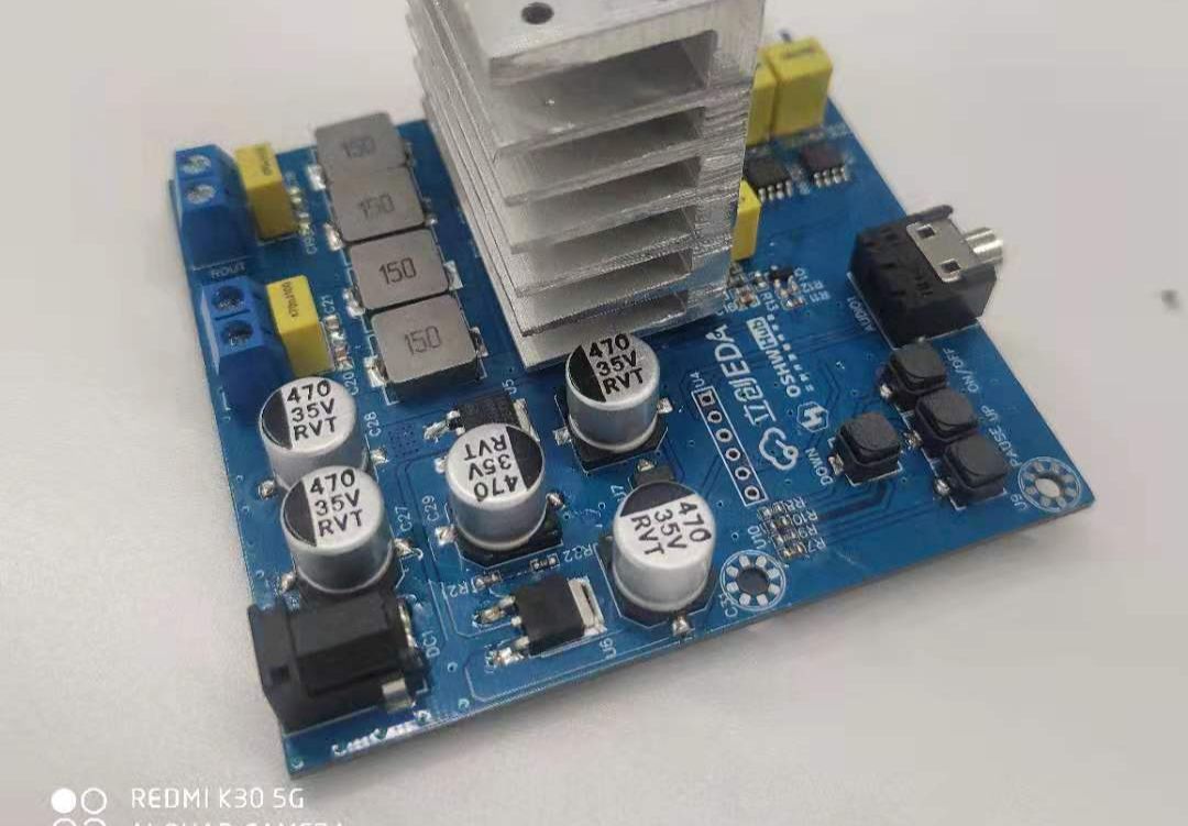

         3. TDA7492 circuit introduction
             The chip has two working modes: silent and standby. This design only uses the silent mode, the silent control pin pin 21, the low-level silent mode. The Bluetooth module defaults to high-level silent mode, so a transistor is added for level conversion.
          The chip can be set externally for gain setting. In this design, a fixed gain is used, and the gain control is added to PIN 30 and PIN 31. Each is connected to the internal LDO of the chip. The gain is controlled at 33.6dB.
      Refer to the chip manual for the output low-pass network. Under 4Ω load, choose 15uH inductor and 470nF capacitor. Try to choose an inductor with a larger current capacity to avoid inductor saturation during bass.
2. PCB display
3D (contest logo needs to be verified)
3. Test
       There was no speaker and no high-power cement resistor was found, so I only tested the input and output waveforms under no load. See the video for details.
       During the test, the 15V power supply voltage used showed clipping distortion when inputting high amplitude in the low frequency band. Increase the power supply voltage and attenuate the input, and the distortion will disappear naturally.
      There is inconspicuous crossover distortion in the high frequency band, which is related to the input capacitance of the oscilloscope's test leads. It may disappear after adding a load. Test again after adding a speaker behind it.
