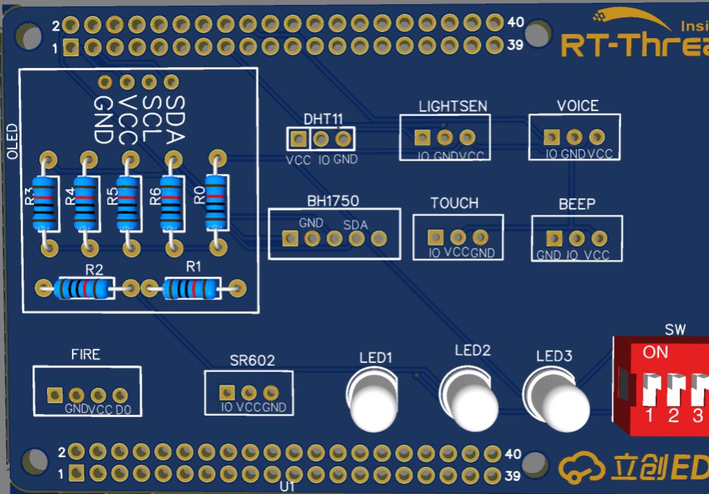

The system hardware connection is shown in the figure below
ART-Pi | hardware | ART-Pi | hardware |
PC2_C | SR602 human body sensing module | PA5 | DHT11 temperature and humidity sensor |
PH15 | flame sensor | PH13 | buzzer |
PA6 | touch sensor | PC6 | Photosensitive sensor |
PH11 | BH1750_SCL | PH12 | BH1750_SDA |
PH11 | OLED_SCL | PH12 | OLED_SDA |
PD13 | KEY11 | PH7 | KEY2 |
PH9 | KEY3 | PH14 | KEY4 |
PG7 | LED1 | PH8 | LED2 |
