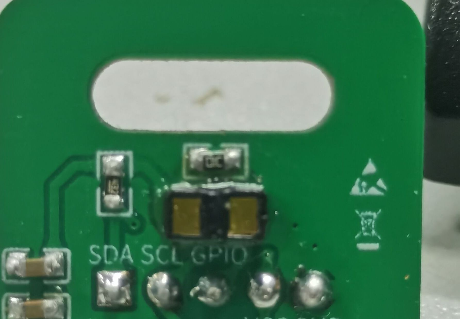

VL53L1 laser ranging
VL53L1X is different from the VL53L0X module. The measured distance of this module is within four meters. You can add a mold to it to increase its performance. The IIC interface has better accuracy, but it is more difficult to weld and requires higher welding requirements.
The analog IIC is written as follows:
