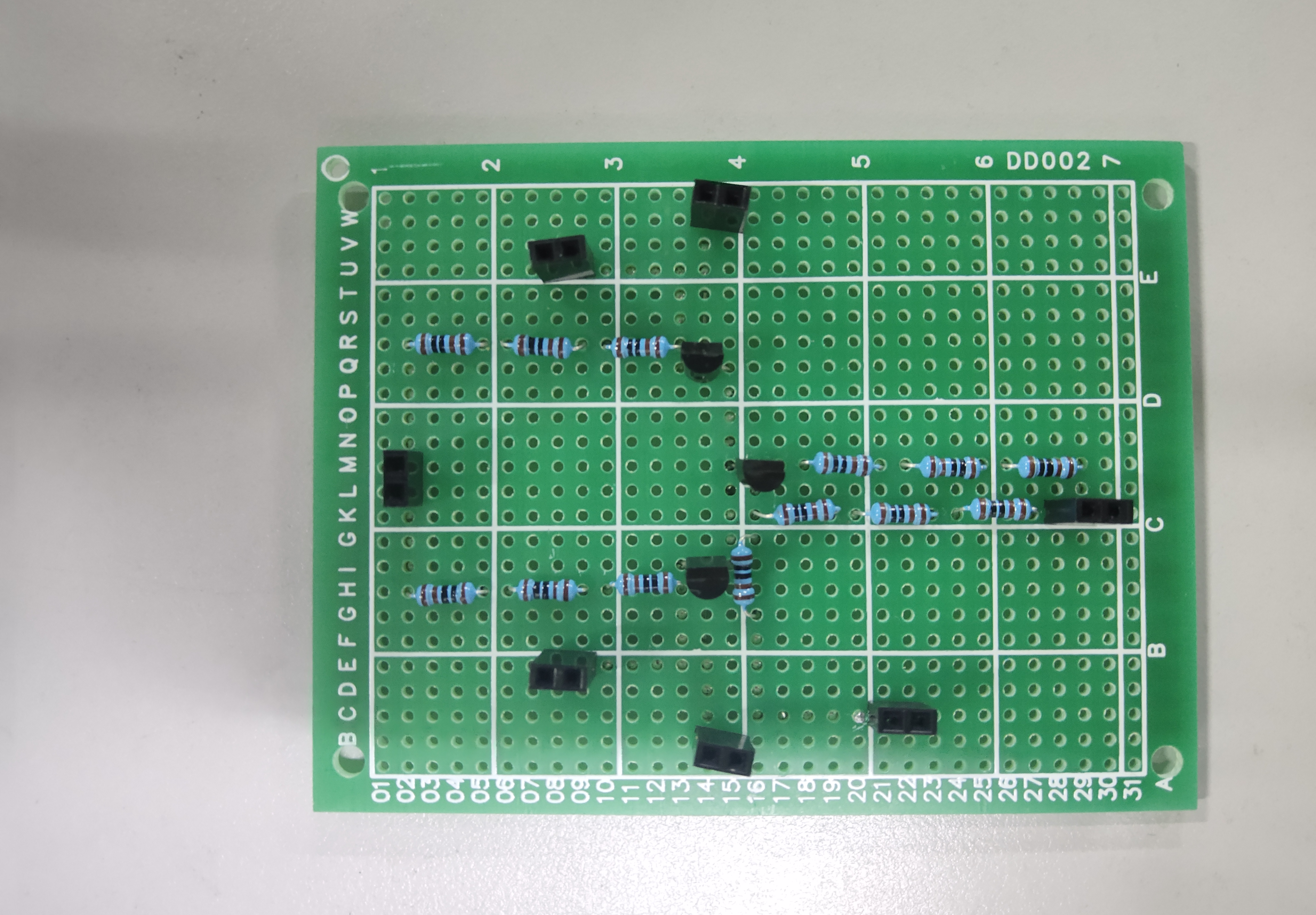

(1) Competition question requirements
(1) Build a triode differential amplifier circuit according to the circuit shown in the figure, and debug it to make it work normally. The transistor uses 9013.
Figure 2 Transistor differential amplifier circuit
(2) Design a differential signal source to test the performance of the produced amplifier and generate the differential signal uid used for testing. uid meets the following requirements:
        a) Common mode signal voltage range: 0V~1V, 10mV step.
        b) Differential mode signal voltage range: amplitude (0-100mV), 10mV step; frequency range 100Hz~1MHz, 100Hz step.
        c) uid common mode signal voltage and differential mode signal amplitude can be set, and the differential mode signal frequency can be set.
        d) The error between the uid parameter index displayed by the tester and the uid parameter index measured and observed by the oscilloscope shall not exceed 5mV.
(3) Measure the magnification and display the record. Measure the voltage amplification factor A of the amplifier at 1KHz.
(4) Input resistance measurement, measure the input resistance of the amplifier at 1KHz.
(5) Measure the amplitude-frequency characteristics of the differential amplifier circuit and display it on the LCD screen to calculate the upper limit cutoff frequency.
(6) Others
(7) Design report

(3) Test plan and test results
After field testing, two 1KHz sine wave differential mode signals with a peak-to-peak value of 0.05V are input, the amplification factor is about 48 times, and the common mode signal is suppressed.
Since the signal generator was not successfully manufactured, the input signal in the test session was the signal generated by the dual-channel signal generator, so the amplitude-frequency curve was not completed.
