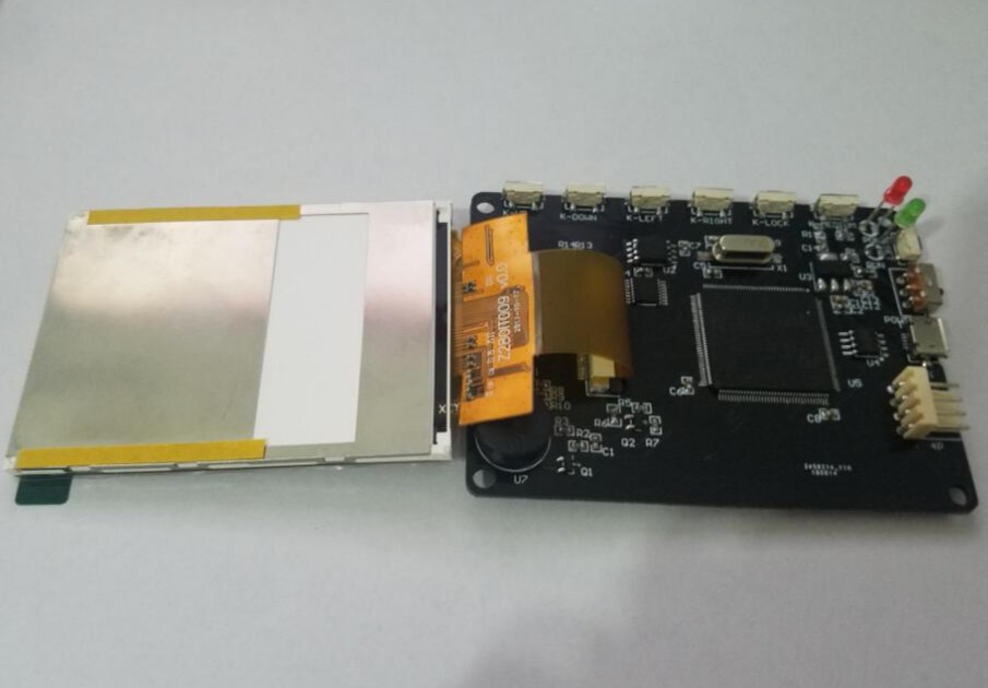

1. Name of the contestant: Cheng Renjie, Wang Hui
2. Name of the entry: STM32/STM8 Offline Downloader
3. Briefly describe your idea and work:
    In current embedded development, STM32 and STM8 are the main control chips used by most engineers. The traditional method is to download the program through a computer and an emulator, and a computer must be configured for production. However, for some mass production, it is obviously appropriate to use a computer, which increases the workload and requires certain professional knowledge. When handing over the production files to the production personnel, it is very likely to cause leakage and huge losses. The offline downloader is small in size and cheap in price. It can set the number of productions and configure encryption in the program, which can effectively protect the production data. At the same time, the offline downloader is easy to operate. As long as the engineer configures it on the computer, he can hand it over to the production personnel with confidence.
4. The materials to be used in the LiChuang Mall: STM32, STM8, W25Q64, buffer, power supply, resistor and capacitor.
5. Intended non-LiChuang Mall materials or other supplements: TFT, shell
6. Intended EDA tool software names: Keil, VS2017, LiChuang EDA design tool
7. Original link: http://club.szlcsc.com/article/details_12812_1.html
8. Original project link: https://oshwhub.com/lengyu1226/wang1111
I. Introduction to the work
1. The appearance picture of the whole machine or the picture of the welded and assembled PCBA;
Click to view full image
II. System architecture diagram
III. Description of the hardware part
1. Schematic diagram:
Click to view full imageClick to view full image2. Implementation principle and system working process:

6. Demonstration of the work
A total of two videos were recorded. The first video demonstrates the operation process of the offline downloader in detail and the explanation time is longer. The second one is a relatively simple demonstration of the entire operation process.
    1): http://url.cn/5ZQU77A?sf=uri
    2): http://url.cn/5OXUQgP?sf=uri
VII. Summary
During the development process, three PCBs were designed using EasyEDA. The first one was not good enough in appearance, and the second one was found to be unreasonable during the test. After three changes, it was finally formed.
It is necessary to support more chip types. The current downloader can support STM32 and STM8 series, but in order to promote it in the future, it is necessary to support more chips. With such a downloader in hand, you can download multiple types of chips without multiple sets of equipment.
The SWD/SWIM debugging stage is difficult to understand, especially for the protocol part, but how to read it carefully and deeply understand the meaning, and finally find it is relatively simple, so when you encounter development problems, you must face them head-on.
