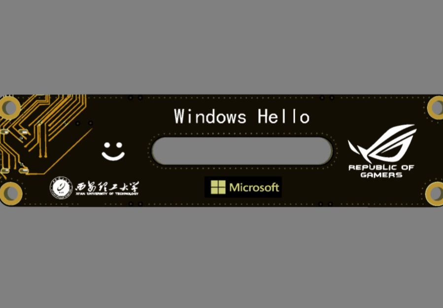

This adapter board adopts an integrated front and back design, using Jialichuang 5 yuan processing double-sided panels, using a 1.2mm plate thickness, one of which is used for welding, and the other is used as a cover. It is recommended to use M3*5 double female copper posts and M3*4 flat head black screws. It has been tested on the board and can be used normally. It is recommended to use a mobile phone ring buckle bracket and traceless tape to fix it on the monitor. It is very convenient to adjust the angle. The renderings are as follows:
