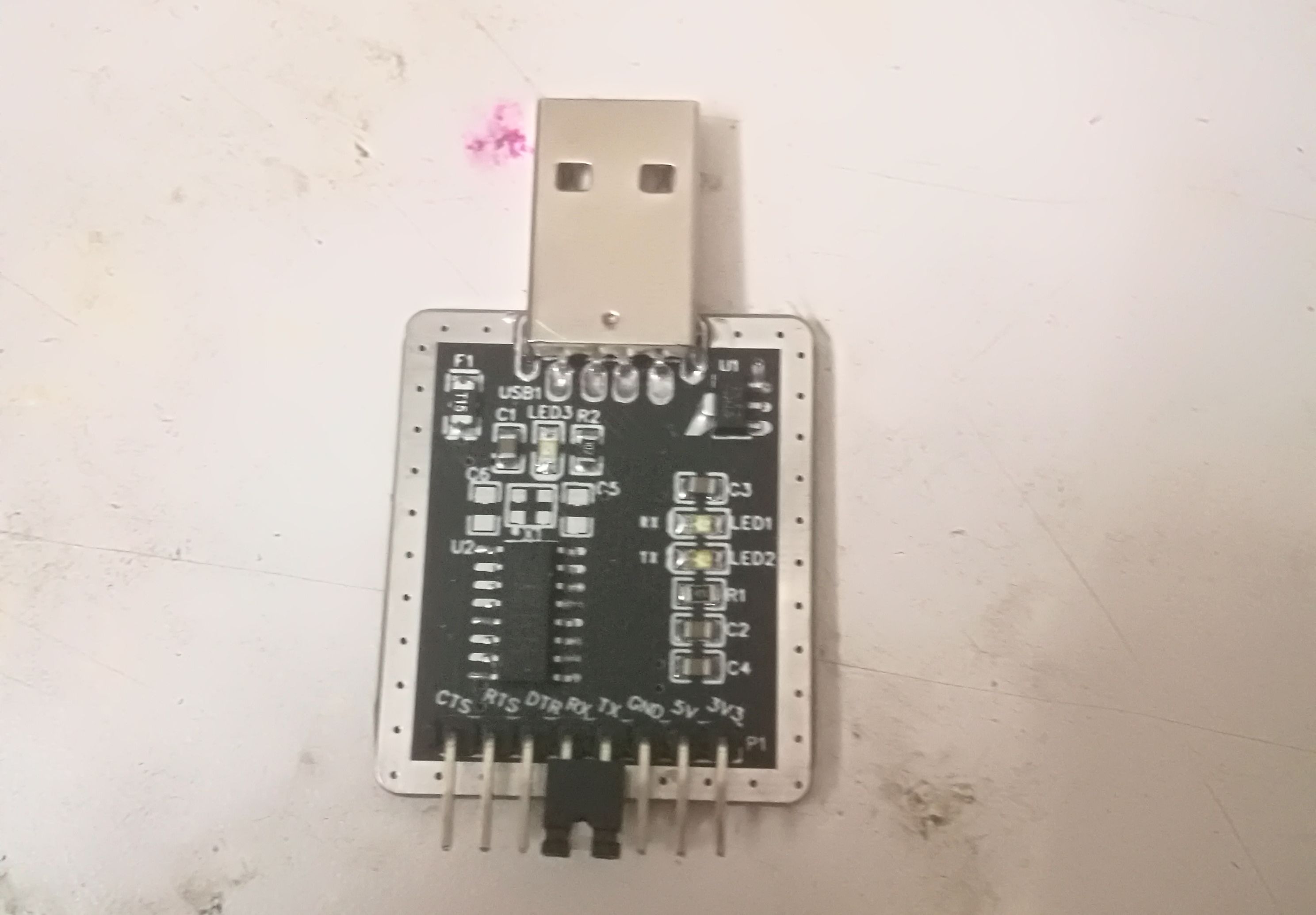

[Successful actual measurement] Solution verification board based on CH340C
This project is used to verify the solution verification design of LCSC’s USB chip CH340C ( LCSC No. C84681 )

This solution verification board adds an 8V1.5A self-restoring fuse to the USB input. The main power supply line is 30mil wide and can pass 2A MAX current. This ensures that when a short circuit or overload occurs, the fuse will be blown first. After the problem is eliminated, it can be used directly, which almost avoids the problem of needing to replace the PCB due to burnt lines. This solution verification board defaults to 3V3 Level mode, suitable for 5V/3V3 level microcontroller, no adjustment required. This solution verification board leads to a total of 8 pins CTS/RTS/DTR/RX/TX/GND/5V/3V3
Attributes type
CTS MODEM contact input signal, clear to send I,#
RTS MODEM contact output signal, request to send O,#
DTR MODEM contact output signal, data terminal is ready O,#
RX serial data input I,pu
Tx Serial data output O,pu
GND power supply P
5V power supply P
3V3 power supply P
Physical welding diagram:IMG_20200415_214123.jpgIMG_20200415_214145.jpg
